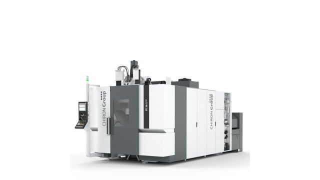

The development of the new CHIRON FZ/DZ16 was determined by your requirements: High precision, dynamics and best surface quality for increasingly complex workpieces. Result of this intensive Dialogue with the market is a fundamentally new machine platform with mobile gantry design. Advantage for you: Outstanding productivity, highest precision and maximum flexibility are no longer a contradiction.
CHIRON FZ16 S
The single-spindle FZ16 S five axis is designed for special precision requirements in 5-axis machining. At the same time, the machining center shines with optimum values regarding dynamics and thus ensures highest productivity. In short: More parts at highest precision.

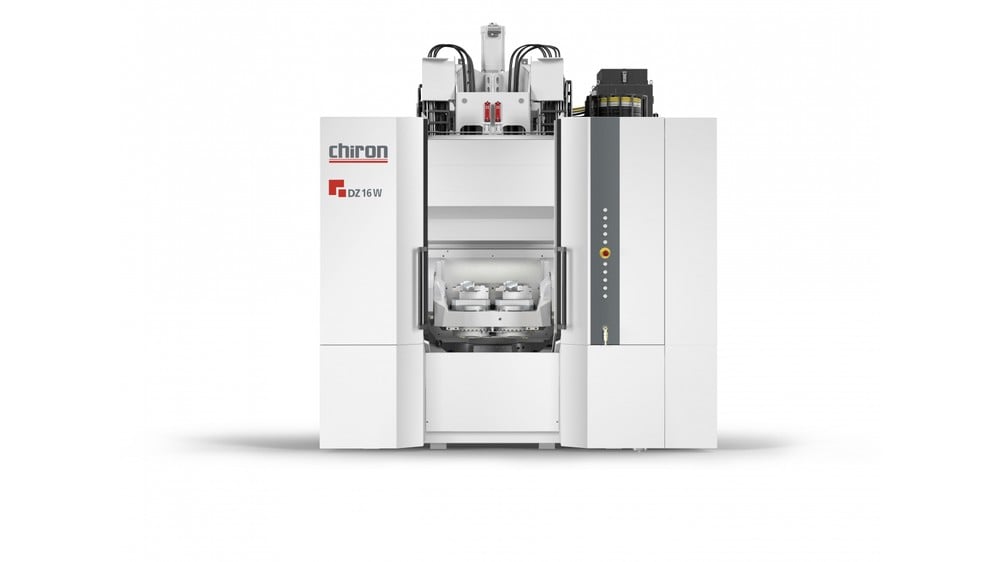

CHIRON DZ16 W
The double spindle DZ16 W with workpiece changing device for loading and unloading during machining is the specialist for larger quantities. With even greater dynamics, the machining center produces complex parts with unprecedented precision. In short: Highly precise parts at maximum productivity.
