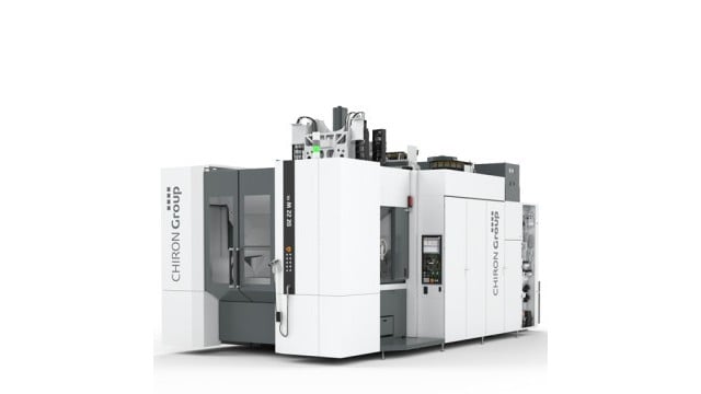

The development of the CHIRON DZ 22 was determined by customer requirements for high precision, dynamics and best surface quality for increasingly complex workpieces. The result of this intensive research with the market has created a fundamentally new machining platform in a driving portal design. Chiron DZ 22 manufacturing centres are available as double-spindle machines.
Every 22 basic machine can be expanded into a perfect individual solution. Your advantage: Outstanding productivity, maximum accuracy and maximum flexibility are no longer a contradiction in terms – even with large components.
Strong performance – high dynamics – the key facts of the 22 series:
  • Reliably high productivity
  • Highest precision and processing quality
  • Small space requirement
  • Fast set-up
  • Easy handling
  • Great stability
  • Highly dynamic
  • Serviceability
Technology information
Travel XYZ max.
620-650-600 mm
Power max.
61.00 kW
Spindle distance DZ with two spindles
600 mm
Spindle speed max.
20,000 min-1
Chip-to-chip time
from 3.1 s
Axis acceleration XYZ max.
10-10-17 m / s2
Rapid traverse max.
75-75-75 m / min
Number of tools max.
2 x 77
Tool holder
HSK-A63 / HSK-A100 / HSK-T63
Workpiece weight max.
600 kg
Workpiece diameter max.
599 mm
