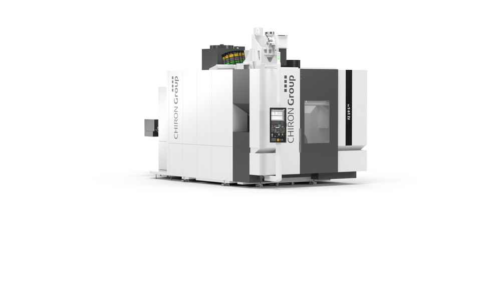

The Chiron Group 19 Series, 5 axis machining centre – delivering impressive power, precision, dynamics and productivity.
Do you manufacture complex components for tools, machinery, power transmission systems, aircraft landing gear, off road and construction vehicles or for energy sectors? Do you need to produce them in series on a single-spindle machining centre? With the FZ 19S five-axis mobile gantry machine, you absolutely can. The new 19 Series model is designed for versatility, making it ideal for a wide range of parts. It embodies the key strengths of the series: power, precision, and dynamic performance, all while ensuring high productivity.
Equipped with CHIRON Group motor spindles, multiple rotary table packages, and tool magazines with capacities of up to 196 tools, the FZ 19S allows for application-specific configurations that maximise customer benefits. The machine ensures minimal downtimes, outstanding performance, and exceptional surface quality. The FZ 19S mill-turn shares these advantages and is specifically designed for turning large, heavy workpieces weighing up to 0.8 tons and measuring up to 800 mm in diameter.
Advantages of the 19 Series
  • Precise, flexible and high-performance machining
  • Mobile gantry design for high static and dynamic rigidity
  • Best thermal stability thanks to actively cooled drive components
  • Gantry round axes with direct torque drive
  • Many tools in the machining center for extensive processing operations
  • Easy access to the working area for set-up, automation and crane loading
  • Tool change during machine operation for maximum output
  • Intuitive operation via TouchLine
  • Most perfectly designed 5 axis work area in regards of dimensions
