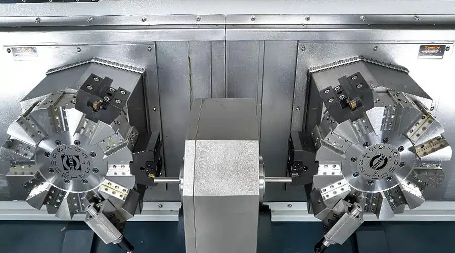

A spindle with in-built hydraulic chuck is installed in the center of the machine bed and two independent tooling systems are installed on the right and left side of the spindle. The machine can turn two ends of parts simultaneously to achieve precise concentricity.
A10 equipped with two front turrets can reduce interference while processing.
It is also user friendly for tool changing and alignment.
It has special designed machine bed which makes the chip removal easier and causes the production line more stable in massive production with automation.

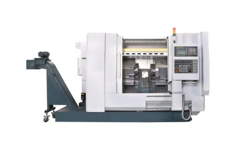

| Item | Description |
| Max Spindle Bore | Φ80 |
| Spindle Motor | 12kW/15kW* |
| Turret | 12 Station Servo Turret |
| Tool Holder | OD:25mmX25mm ID:25mm |
| Machine Control | Fanuc |
| Recommended Option | Automated Part Loader / Power Turret / 70Bar High Pressure Pump Units. |
| Machine Weight | 5000 kg |
| Standard | Option |
| Full Guard | Automation part Loader System |
| Coolant System | BMT Power turret |
| Air Conditioner | High Pressure Coolant Pump Unit |
| Operator Panel | Oil Mist Collector |
| Pneumatic / Hydraulic System | Light Curtain |
| Collet | Auto-measurement Device |
| Lubrication System with Lube Tag | Oil Skimmer |
| Steel Belt Chip Conveyor | |
| Chip Bucket | |
| 3 Color Tower Light | |
| LED Working Light | |
| Tool Box for Set Up | |
| Safety Guard |
