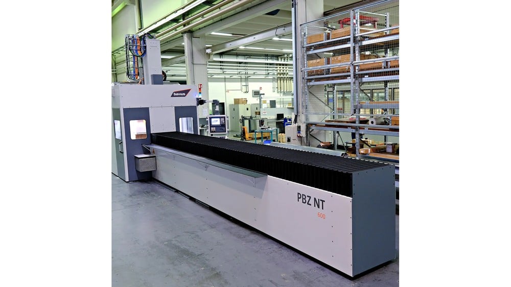

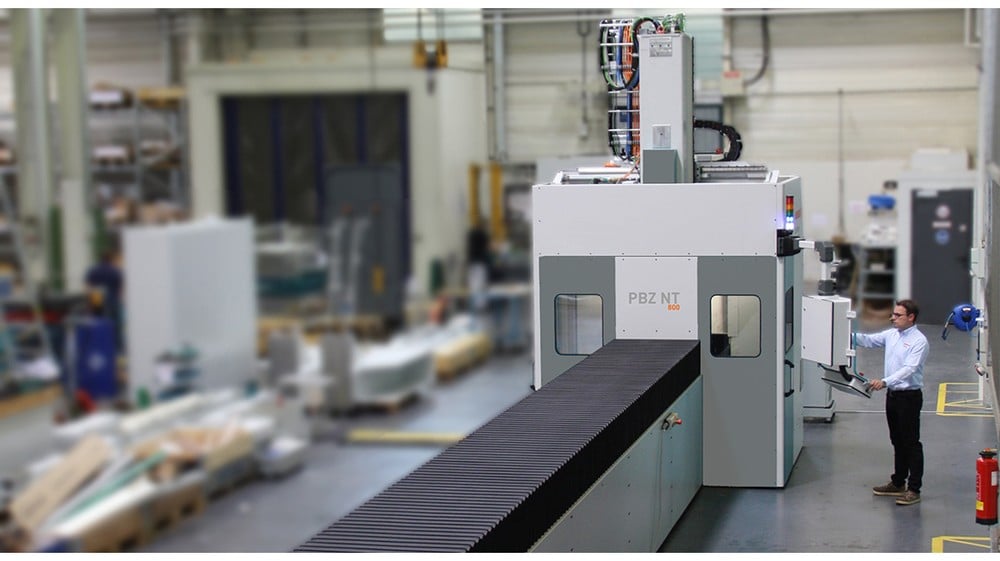

Powerful 5-axis CNC machining centre.
The PBZ NT profile machining centre delivers high-performance (HSC) milling of curtain walls and aerospace structural parts.
Accuracy and efficiency
Profile machining with high precision and outstanding flexibility! The PBZ NT profile machining centre owes its stability to its fixed gantry. This allows aluminium, steel, extruded profiles and other extrusions to be machined precisely and extremely efficiently.
Complete machining without interference contours

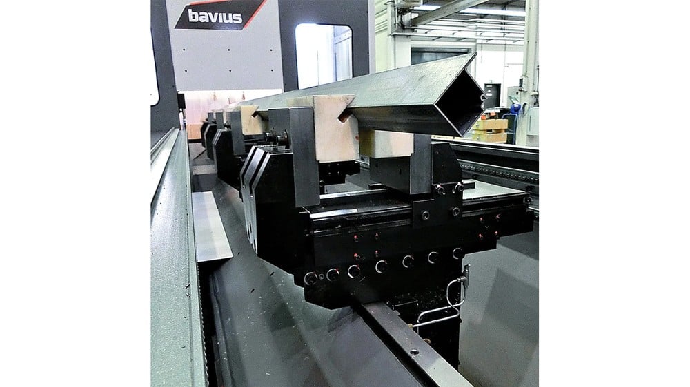

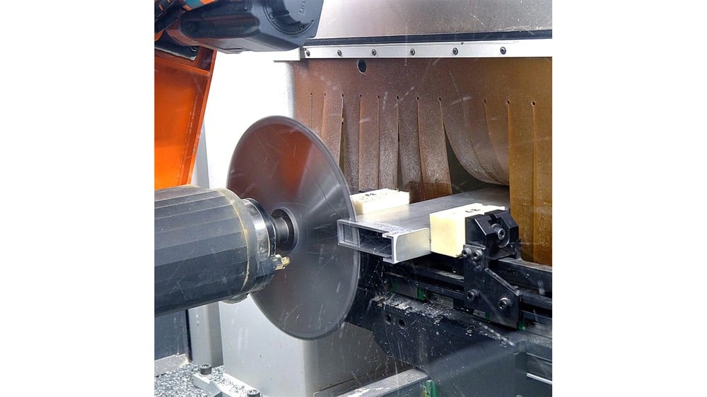

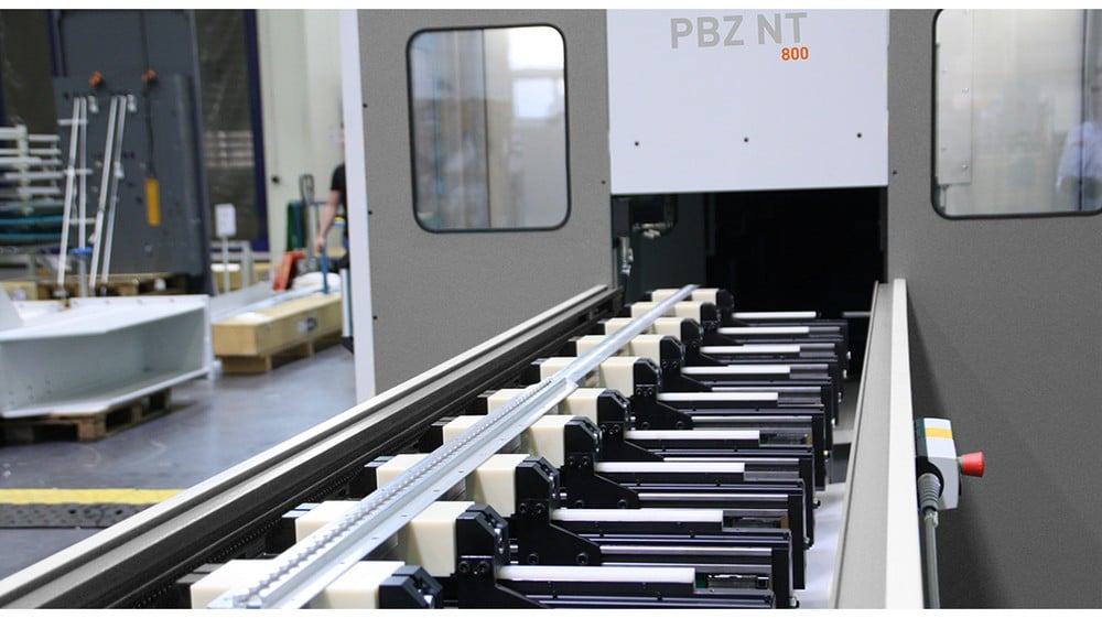

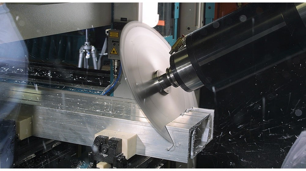

Milling, sawing, drilling and thread milling are possible without workpiece interference in 6-sided complete machining. The bavius clamping technology allows face machining of several short profile parts and is specifically designed for long profiles. The precise x-axis positions the part in the stationary workspace.
Profile machining centre for flexible and powerful 6-side HSC complete machining. 6-side profile machining with high accuracy as well as outstanding flexibility? That is where the PBZ NT comes into its own. The fixed portal of the PBZ NT is the basis for the high stability of the profile machining centre, which allows precise and powerful machining of aluminium and steel sheet profiles and extrusions. The intelligent clamping technology permits end machining of several short profile parts or a long profile as well as interference-free 6-side complete machining, including milling, sawing, drilling, shift cuts and thread milling and cutting.
Your Advantages
  • Significantly shorter set-up times thanks to 6-sided complete machining in one clamping operation
  • Batch production, e.g. production of entire part sets from one profile thanks to vice position adjustment for profile lengths up to 25000 mm
  • Production in sets, e.g. production of entire sets of parts from one profile thanks to vice displacement
  • Machining without workpiece interference thanks to freely positionable vices
  • High precision machining thanks to a robust, compact machine concept
  • No special machine foundation necessary
  • Powerful HSC machining of aluminium and steel sheet profiles and extrusions
  • Special rigid clamping vice design with high clamping force allows the machining of steel profiles
  • Interference-free 6-side complete machining up to 25,000 mm
  • Machining on both profile ends
  • Burr-free machining thanks to HSC technology
  • Very high axis speed in X
  • Proven machine kinematics
  • Best ergonomics
  • Fully enclosed workzone
