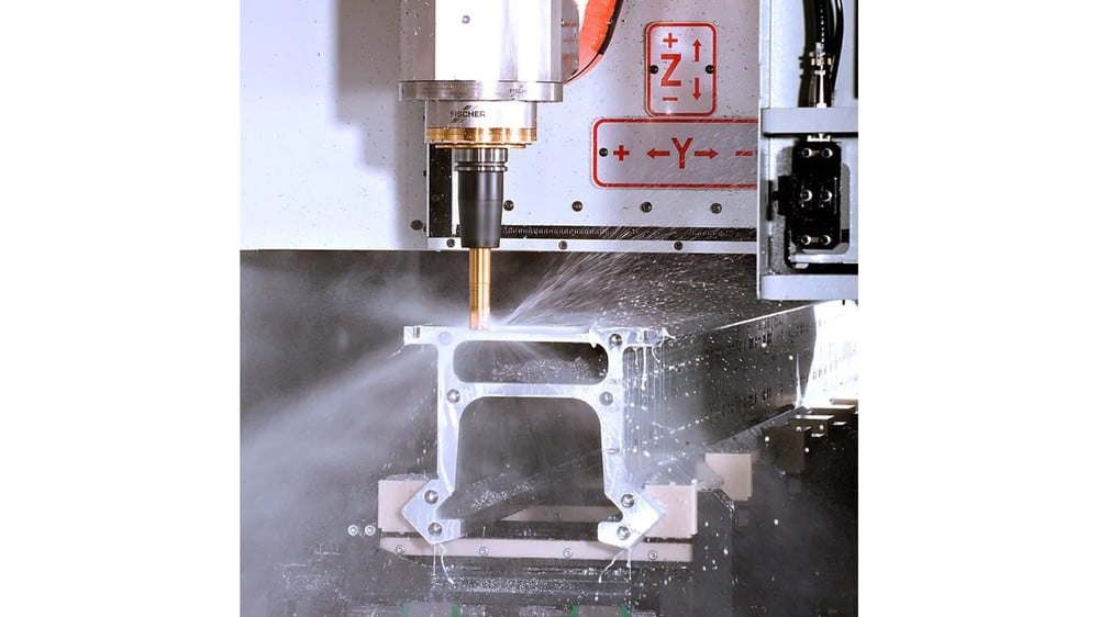

The PBZ SD profile machining centre delivers dynamic pendulum machining of profiles and extrusions up to 24000 mm for high productivity and is especially proven in the aerospace industry.
Loading and unloading while production is in progress

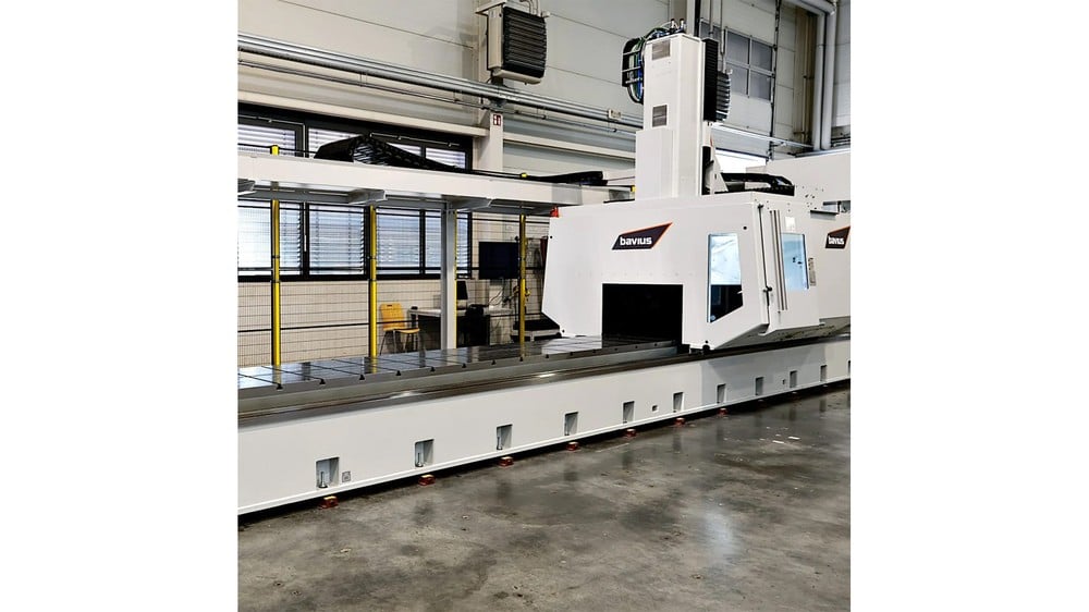

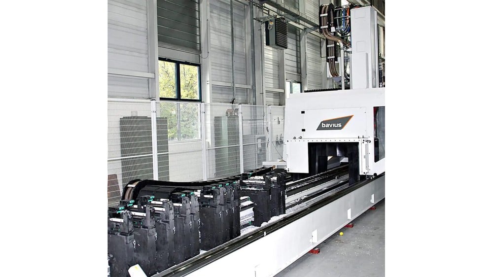

Do you want to reduce non-productive time without additional automation? The PBZ SC profile machining centre with pendulum machining capability is the answer. The PBZ SC profile machining centre’s pendulum machining provides two spatially-separated working areas which allow workpieces to be loaded and unloaded while cutting is in progress.
Machining without workpiece interference
Aluminium and steel profiles up to a maximum length of 24 000 mm are machined on a small machine footprint and with a very powerful spindle. The robust machine design is the basis for high precision and outstanding quality with 6-sided machining without workpiece interference.

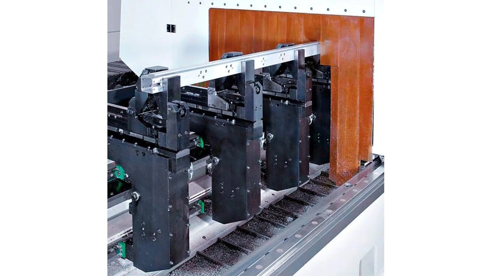

Proven bavius clamping technology
The PBZ SC incorporates proven bavius clamping technology to ensure efficient workpiece clamping.
  • Flexible clamping technology for machining all common profile cross sections
  • Multiple vice or table variants
  • Freely positionable vices across the entire length
  • Simple changing of the clamping elements
  • Multi-functional vices for sensitive surfaces
