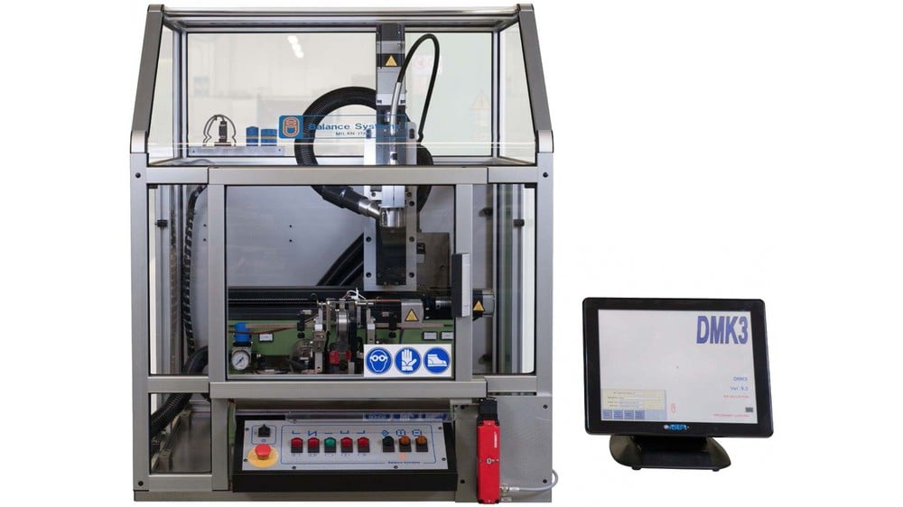

Semi-automatic balancing machine
Features

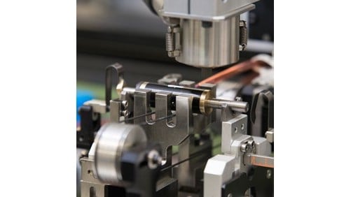

- Semi-automatic balancing machine for small rotors weighing between 0.05 kg to 0.5 kg (0.11 and 1.10 lb).
- The material removal is carried out in a completely automatic way on two planes (dynamic).
- The unbalance is corrected by removing material on the lateral rings as an outcome of radial drilling.
- Manual loading/unloading.
Advantages
- High measuring precision
- High balancing precision.
- User friendly.
- Quick and precise changeover by preset mechanical stops.

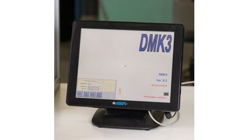

Technology information
| Minimum rotor weight: | 0.05 kg (0,11 lb) |
| Maximum rotor weight: | 0.5 kg (1,10 lb) |
| Rotor OD: | 8-40 mm (0,31-1,57 in) |
| Controlled by: | Industrial PC |
| Machine cycle time: | 40 s (measuring, two plane drilling, audit) |
| Measuring precision: | 0.1 gmm/kg (0,04 oz.in/lb) |
| Balancing method: | Radial drilling |
| Power supply: | 120-240 V 50/60 Hz |
| Machine dimensions (LxWxH): | 950 x 1700 x 1900 mm (37,40 x 66,93 x 74,80 in) |
