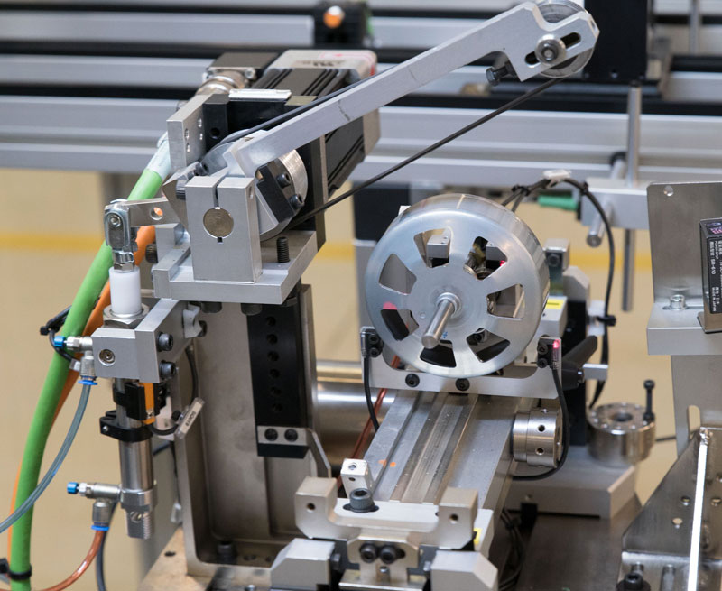

Automatic balancing machine for HVAC armatures
Features

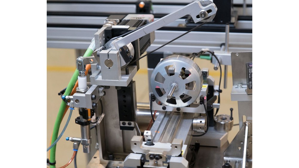

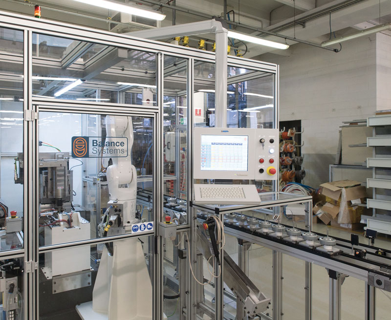

  • Fully automatic balancing machine, specifically developed for balancing rotors of brushless motors and similar rotating parts, in a completely automatic way, on two planes (dynamic).

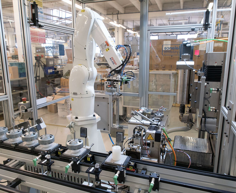

  • It is composed of: a measuring unit and a milling unit for left and right planes. The parts manipulation is performed by an embedded anthropomorphic robot equipped with double gripper.
  • The unbalances are automatically corrected by removing material by radial milling on the outer diameter of the rotor.
  • It can be implemented in any type of production lines (pallet, step, by loop, etc.).

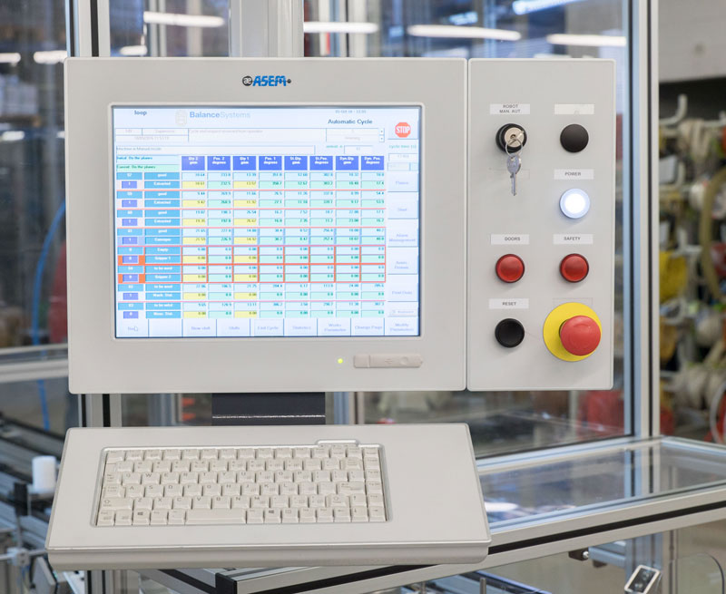

Controlled by: Industrial PC
