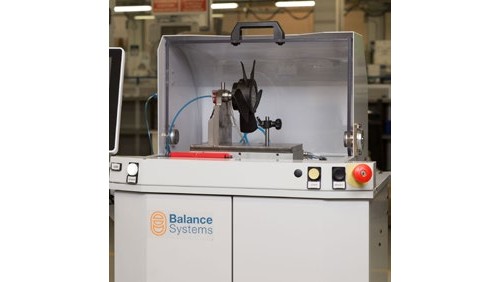

Manual balancing machine
Features

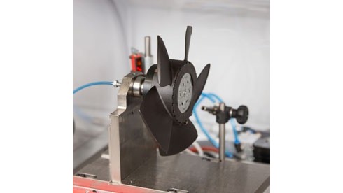

  • Manual balancing machine able to measure the unbalance of rotors fans on two planes (dynamic) or on one plane (static). The correction of the unbalances is carried out manually and it is performed by adding clips on blades fans.
  • The machine can balance fans or motors assembled with fans.
  • Operator interface by industrial PC.
  • High level of flexibility and quick changeover.
