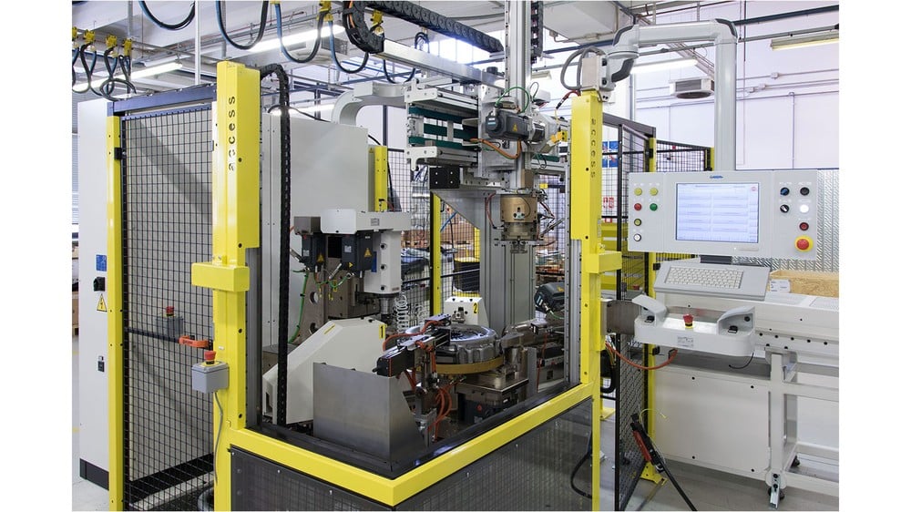

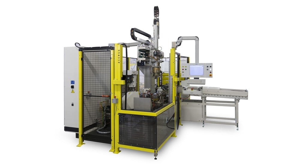

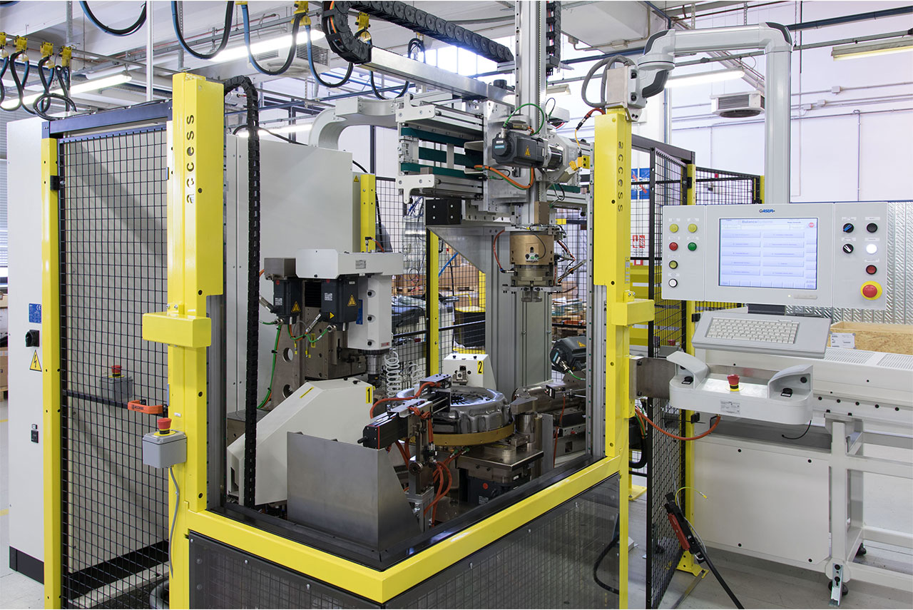

Features

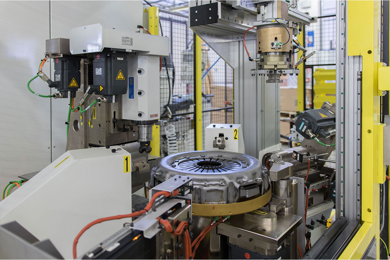

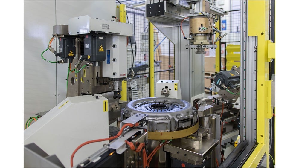

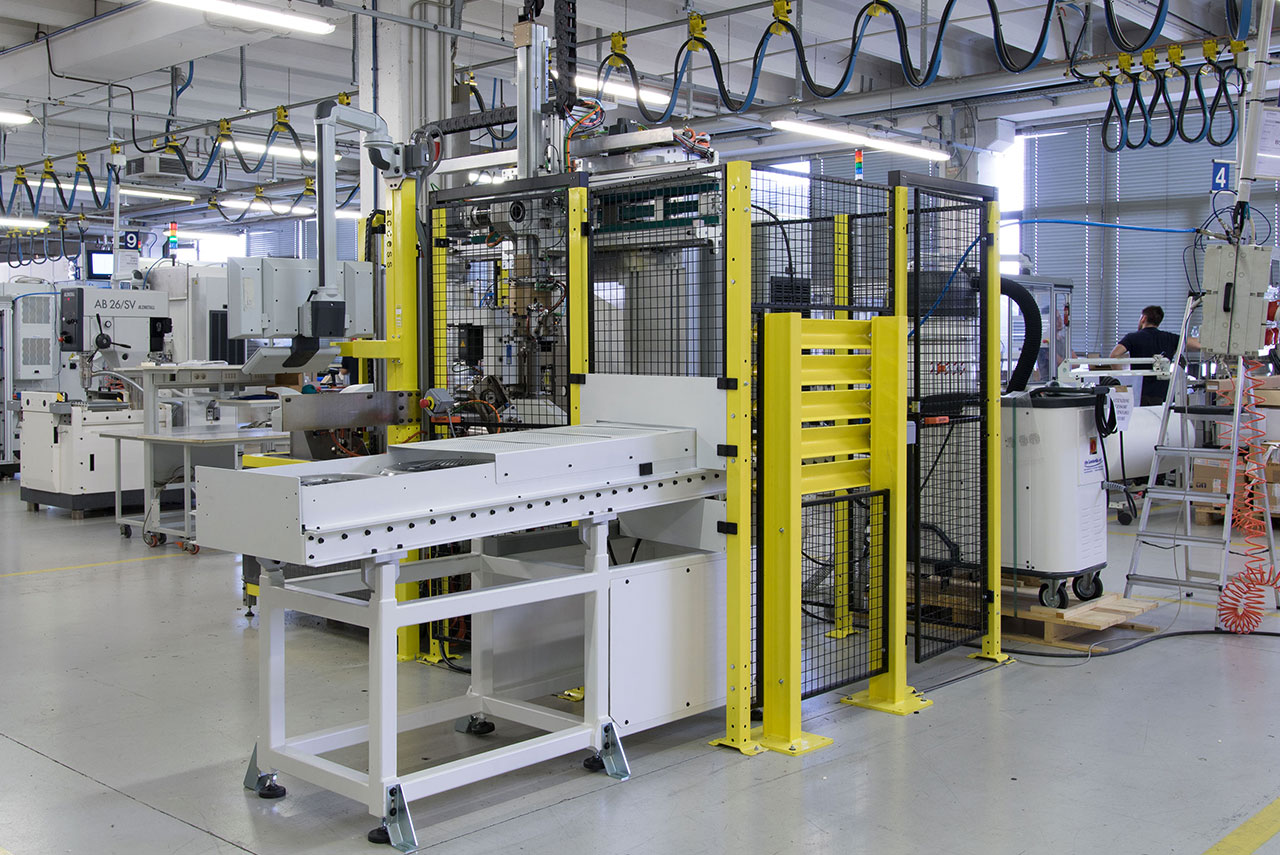

  • Vertical automatic balancing machine, specifically developed for the balancing of assembled clutches on one plane (static). The unbalance is automatically corrected by axial milling and/or radial drilling.
  • The milling unit is controlled by three axis and the correction is carried out by axis interpolation.
  • It is composed of; measuring unit, axial milling with three controlled axis and an axial drilling unit (option).

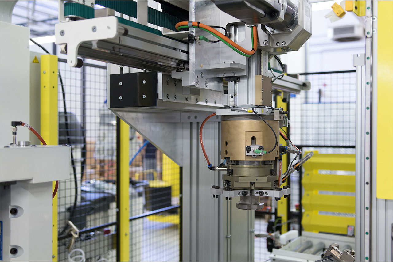

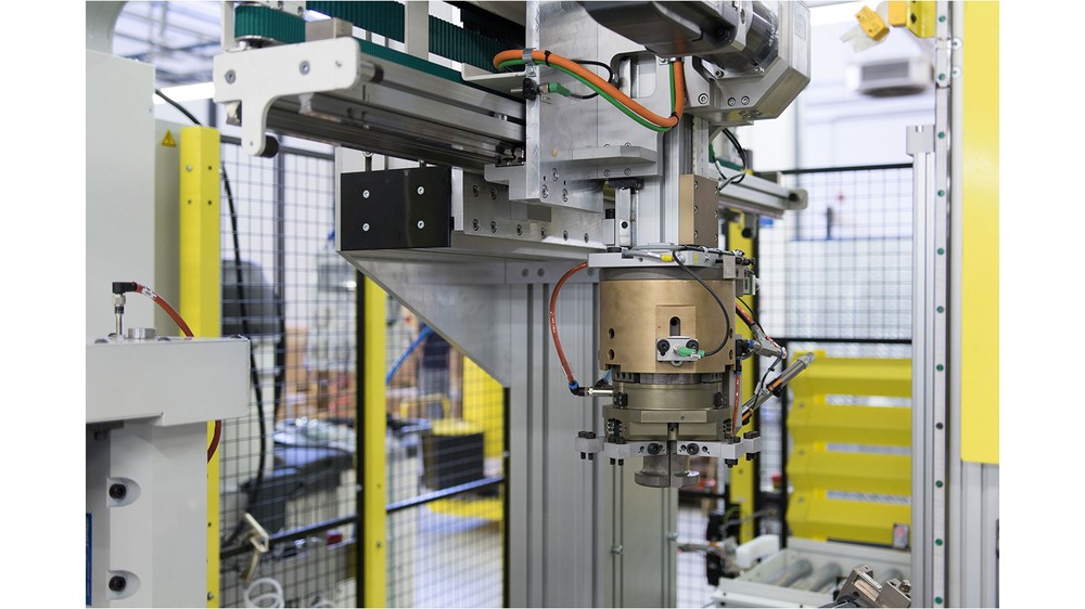

  • Parts loading is performed by an operator, while parts unloading is automatically performed by a controlled pick and place with an expandable gripper.
  • High level of flexibility and quick production changeover.
