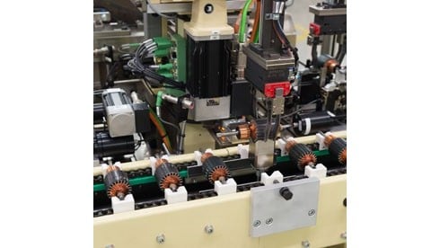

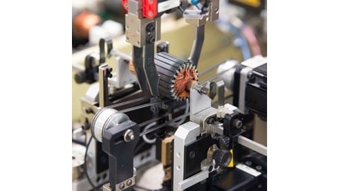

  • Fully automatic balancing machine for armatures of electric motors.
  • It is composed of: a measuring unit, a milling unit for left and right planes and one audit unit.
  • Standard configuration with milling in length and depth.
  • The machine can be delivered (upon request) with “V” or polar cutters.

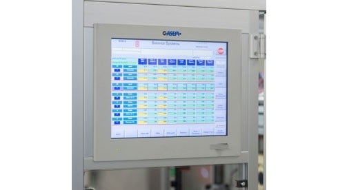

  • Operator interface by industrial PC (Windows™).
  • Option such as vacuum system for milling chips, reject conveyor, SPC and printer, teleservice

Balancing methods: Polar or vectorial milling in length and depth
