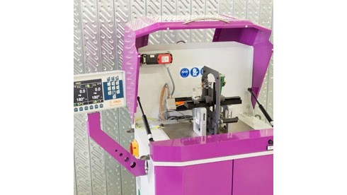

TRB3000 by balance-systems
Turbochargers balancing machine
Features:
  • The TRB3000 balancing machine has been designed for balancing turbocharger rotors in all the possible configurations: turbine wheels, compressor wheels, and assembled rotors.
  • It is a compact machine equipped with a measuring electronic unit and a VM25 control panel.
  • The machine is extremely accurate. Unbalance measurement and correction on two planes.
Advantages:
  • Compact design
  • High measuring precision
  • User friendly
  • Hard bearing support
  • Loop belt drive
Technology information
Max rotor weight: (with fiber support) 0.5 kg (1,10 lb)
Max rotor weight: (with bearing support) 5.5 kg (12,13 lb)
Journal diameter: 2-40 mm (0,08-1,57 in)
Max rotor diameter: 120 mm (4,72 in)
Range of belt dragging diameter: 4-60 mm (0,16-2,36 in)
Min distance between support: 20 mm (0,79 in)
Max distance between support: 250 mm (9,84 in)
Balancing speed: 200-2800 rpm
Min achievable residual unbalance: 0.01 gmm (0,0089 oz/in)
Power supply voltage: 110-230 V
Power requirement: 0.3 kW
Machine dimensions (LxWxH): 950 x 700 x 1300 mm (37,40 x 27,56 x 51,18 in)
