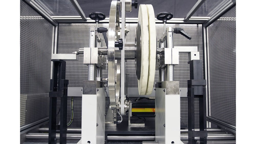

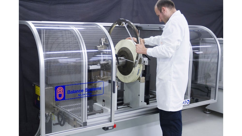

  • The RB250 is a universal horizontal balancing machine provided with hard bearings support. It is capable of balancing on two planes (dynamic) or on a single plane (static) a wide range of cylindrical rotors, shafts, spindles, etc. weighting between 5 and 250 kilos (11.02 lb and 551.16 lb).
  • Operating interface by industrial PC with touch screen.
  • The correction of the unbalances is carried out manually and it is performed by an operator through material addition or removal.
  • High level of flexibility and quick changeover.
