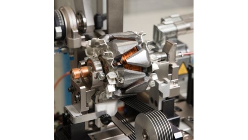

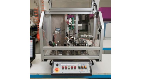

  • MK3-A is a manual balancing machine suitable for measuring the unbalance of alternators rotors on two planes (dynamic) or on one plane (static).
  • The correction of the unbalance is carried out manually by adding or removing material.

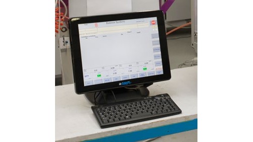

  • The measuring unit is equipped with all the devices and instruments necessary for a quick and safe changeover.
  • Software is available to support the operator to correct unbalances by drilling.
  • The standard machine includes SPC, diagnostics, safety shield.
