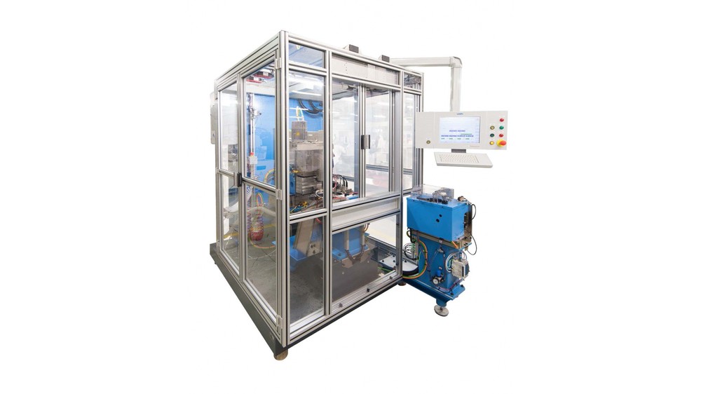

BVK4-5-3R by balance-systems
Semi-automatic balancing machine
Features

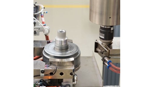

  • Semi-automatic balancing machine, specifically developed for balancing rotors for brushless motors and similar rotating parts, in a completely automatic way on two planes (dynamic).
  • The unbalance is automatically corrected by removing material as an outcome of radial milling.

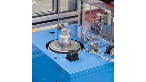

  • Parts manipulation performed by the operator.

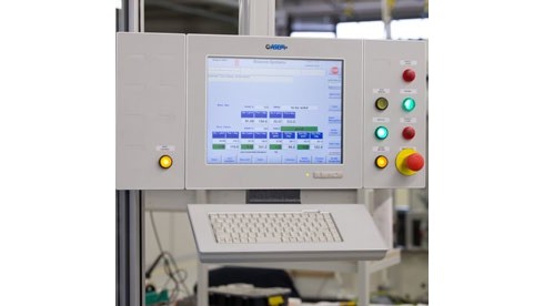

  • Operator interface by industrial PC.
  • High level of flexibility and quick changeover.
Advantages
  • Automatic set-up
  • High level of repeatability and precision of the unbalance measuring
  • Diagnostic and preventive maintenance program
  • Quick changeover
  • High level of reliability
  • User friendly
Technology information
Max rotor weight: 3 kg (6,61 lb)
Rotor diameter: 50-140 mm (1,97-5,51 in)
Stack lamination height: 20-70 mm (0,79-2,76 in)
Max production rate: 120 pcs./hour
Controlled by: Industrial PC
Measuring precision: 0.1 gmm/kg max
Balancing method: Radial milling
Power supply: 380-480 V three-phase 50/60 Hz
Machine dimensions (LxWxH): 1500 x 2500 x 2200 mm (59,06 x 98,43 x 86,61 in)
