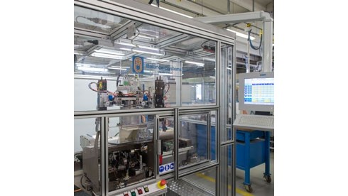

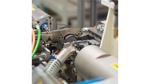

  • Semi-automatic balancing machine, specifically developed for balancing rotors for asynchronous motors and for brushless motors and similar rotating parts, in a completely automatic way on two planes (dynamic). The unbalance is corrected by removing material as an outcome of axial drilling.
  • It is composed of: one measuring unit, two drilling units (one for each balancing plane) and a rotary table with pneumatic pliers for parts manipulation (from measuring unit to drilling units and vice versa).
