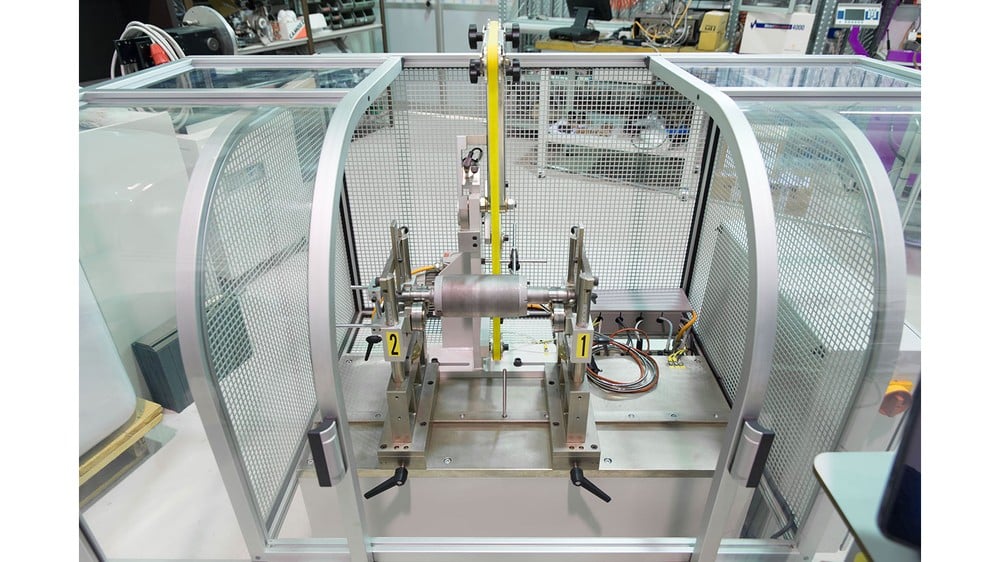

Manual balancing machine
Features

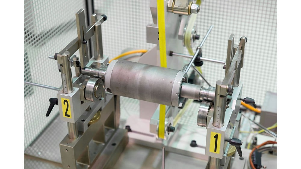

  • The RB50 is a universal horizontal balancing machine provided with hard bearings support. It is capable of balancing on two planes (dynamic) or on a single plane (static) a wide range of cylindrical rotors, shafts, spindles, etc. weighting between 1 and 50 kilos (2.20 lb and 110.23 lb).

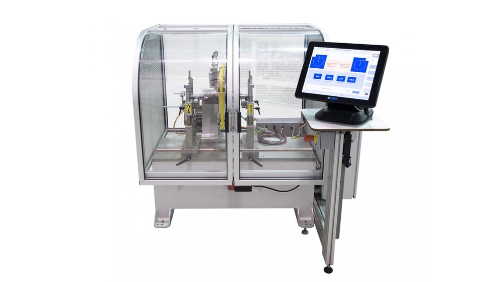

  • Operating interface by industrial PC with touch screen.
  • The correction of the unbalances is carried out manually and it is performed by an operator through material addition or removal.
  • High level of flexibility and quick changeover.
