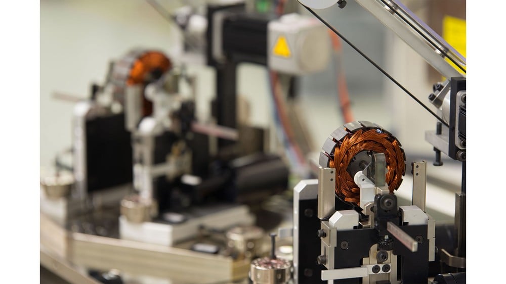

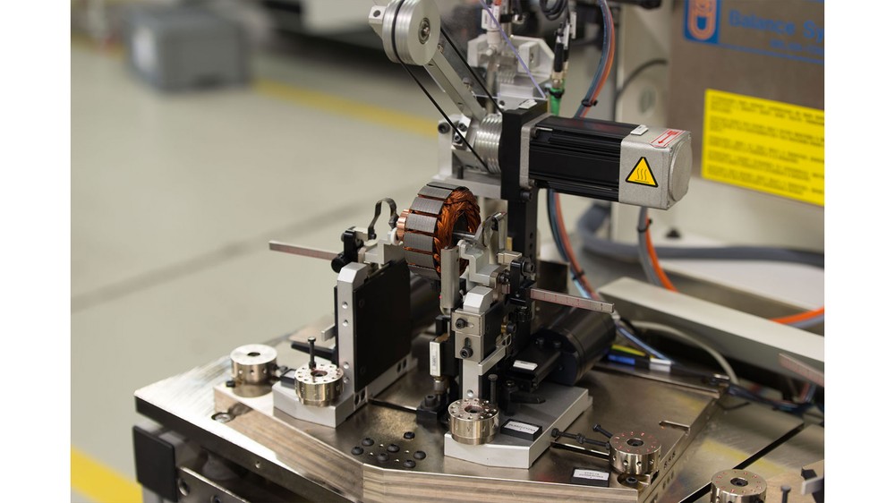

  • The MK3-25 is a manual machine suitable to measure the unbalance of rotating parts on two planes (dynamic) or on one plane (static). The unbalance correction is carried out manually by adding or removing material.
  • The main use of this machine is to balance rotors/armatures of electric motors in general, as well as car alternators or fans, turbines, brushless rotors, shafts, spindles, etc.
  • This machine can be interfaced to manual milling/drilling units to rectify the unbalance by removing material.
  • Operator interface by industrial PC.
  • High level of flexibility and quick changeover.

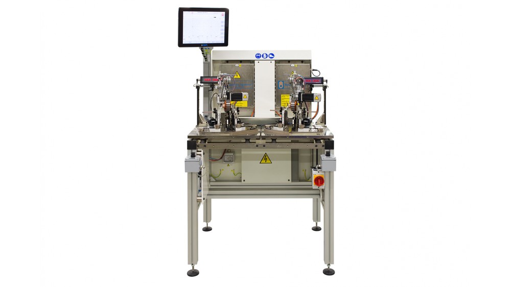

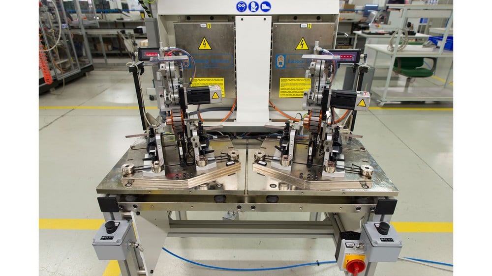

Technology information
Max rotor weight 25 kg (55.11 lb)
Rotors diameter 30-170mm (1.18-6.69 in)
Stack lamination height 40-200mm (1.57-7.87 in)
Unbalance measuring time: 8-20 s
Controlled by Industrial PC
Drive systems: Tangential or loop belt
Balancing method Material adding or removal
Measuring precision: 0.5 gmm/kg max
Power supply 110-230V 50/60Hz
Machine dimensions (LxWxH) 840 x 680 x 580 mm (33.07 x 26.77 x 22.83 in)
