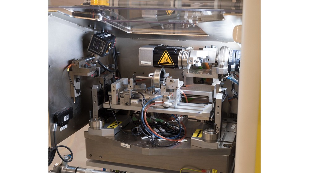

  • Semi-automatic balancing machine for balancing rotors for brushless motors.
  • Composed of: measuring unit, milling unit for left and right planes and pneumatic pick and place for the manipulation of the parts (from measuring unit to milling unit and vice versa) to audit the balanced rotors.
  • Standard configuration with milling in length.
  • The machine can be delivered (upon request) with components or polar milling tools.
  • Manual loading / unloading.
Advantages
  • Highly skilled operator not required
  • PC based operator interface
  • Easy to maintain
  • Diagnostic and preventive maintenance programs
  • High level of repeatability and precision of the unbalance
  • Compact dimension
  • User friendly
Technology information
Max rotor weight: 3 kg (6,61 lb)
Rotors OD: 10-85 mm (0,39-3,35 in)
Stack lamination height: 10-80 mm (0,39-4,72 in)
Machine cycle time (measuring, milling, re-cheking): 24 s
Controlled by: Industrial PC
Measuring precision: 0.1 gmm/kg (0,04 oz.in/lb)
Balancing methods: Vectorial, polar, milling in length and depth
