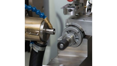

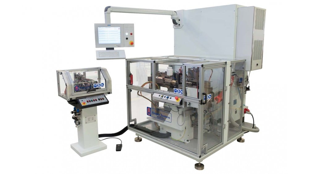

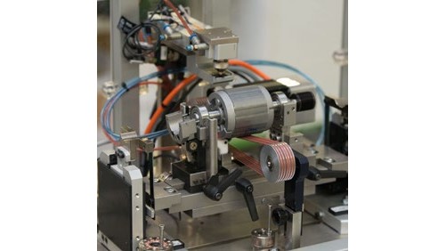

  • Semi-automatic balancing machine, specifically developed for balancing rotors for asynchronous motors, brushless motors and similar rotating parts, in a completely automatic way on two planes (dynamic).
  • The unbalance is corrected by removing material as an outcome of radial drilling or axial milling.

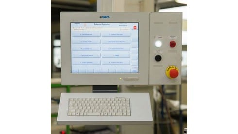

  • Operator interface by industrial PC.
  • High level of flexibility and quick changeover.

Max rotor weight 4 kg (8,82 lb)
Rotor diameter: 20-80 mm (0,79-3,15 in)
Stack lamination height: 20-80 mm (0,79-3,15 in)
Max production rate: 140-180 pcs./hour
Controlled by: Industrial PC
Measuring precision: 0.1 gmm/kg max (0,04 oz.in/lb)
Balancing method: Radial drilling or axial milling
Power supply: 380-480 V three-phase 50/60 Hz
Machine dimensions (LxWxH): 1500 x 1700 x 2200 mm (59,06 x 66,93 x 86,61 in)
