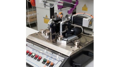

MK3 by balance-systems
Manual balancing machine
Features

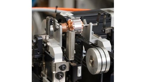

  • MK3 is a general purpose balancing machine recommended for processing small productions or to be used in testing laboratories for production development or to perform quality controls.
  • The unbalance correction is carried out manually by adding or removing material.

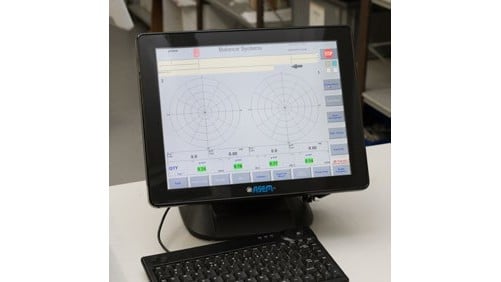

  • This machine is supplied with a mechanical measuring device connected to an industrial PC.
  • The unit is equipped with all the devices and tools necessary for rapid and secure changeover.
  • Software is available to support the operator to correct unbalances by drilling.
  • The standard machine includes SPC, diagnostics, safety shield.
  • MK3 may also be installed in an automatic line so as to act as a sorting machine (GO-GO no sorter).
