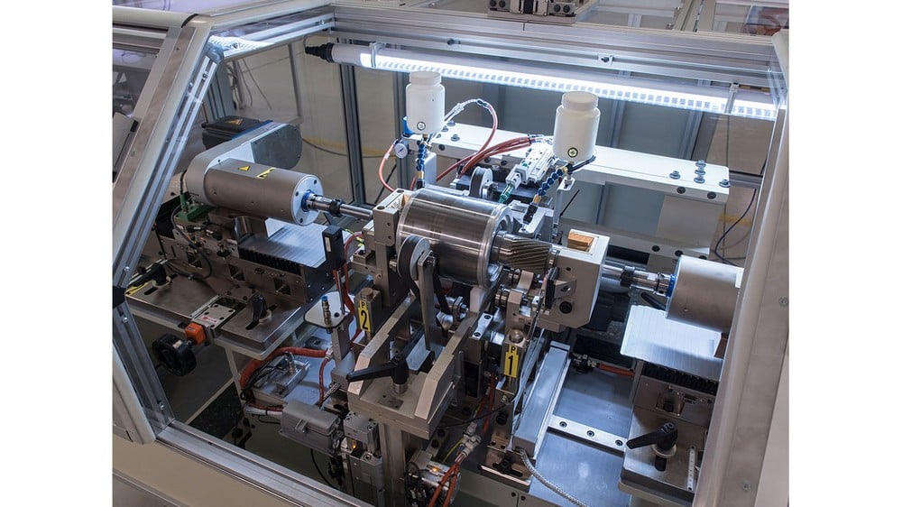

Automatic and semi-automatic balancing machine for the electric transmission rotors
Features
  • Semi-automatic balancing machine able to balance the entire range of rotors for electric motors weighing up to 25 Kg in a completely automatic mode on two planes (dynamic).
  • This machine is specifically developed to balance the rotor for the electric transmission on the automotive field.

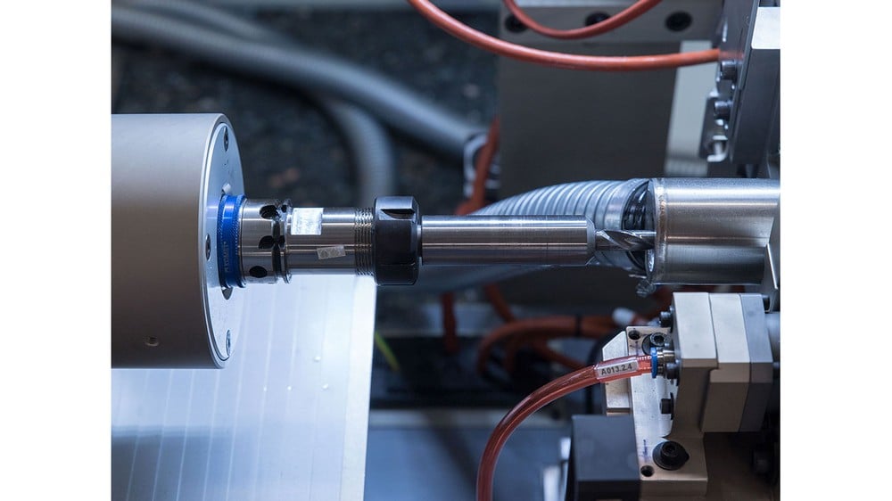

  • The unbalances are corrected by axial drilling to remove material on the lamination stack.
  • Loading/unloading of the piece is manual but the machine can be easily equipped with industrial robot or linear pick and place making the RB50A a fully automatic balancing machine.
Advantages
  • High level of flexibility
  • High measuring precision
  • High balancing precision
  • Quick production change over
  • User friendly
Technology information
Max rotor weight: 25 kg (55.11 lbs)
Max rotor diameter: 200 mm (7.87 in)
Max stack lamination length: 230 mm (9.05 in)
Cycle time: 90 s (measuring, two planes drilling, audit)
Controlled by: Industrial PC
Drive system: Loop belt
Measuring precision: 0.1gmm/kg
Power supply: 400 V three-phase 50/60 Hz
Machine weight: 2000 kg (4409 lbs)
Machine dimensions (LxWxH): 2111x1960x2422 mm (83.11×77.16×95.35 in)
