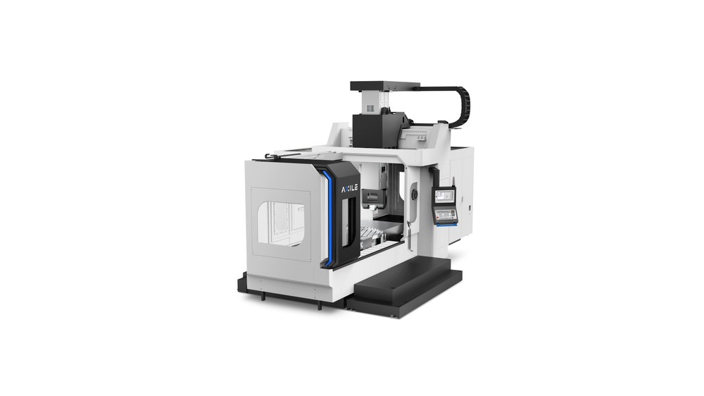

DC12 by axile
The DC12 is the most robust VMC in AXILE’s arsenal, perfectly suited for handling larger, lengthy workpieces. With a 1200 mm diameter built-in table and 2.5 tonnes maximum weight capacity, the DC12 is able to accommodate large and heavy 5ax components, while the 2,200 x 1,200 mm machine bed will take on board long and complex parts common in the aerospace, power generation, and die and mould industries. Its double-column bridge construction allows for greater rigidity, as well as greater control over thermal deformation. As a result, the DC12 is capable of deep cuts and complex contouring while maintaining utmost precision.
A snapshot of the AXILE DC12:
  • Massive bridge supported on a one-piece base casting
  • Machine body made of high-quality cast iron
  • 3-guided Y-axis carriage to ensure speed and stability
  • Extremely rigid 4-guided Z-axis Box-in-Box designed RAM
  • Torque motor driven B (spindle) and C (table) axis
  • Large tool magazines as standard
  • Various pallet changer solutions as option
