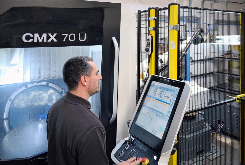

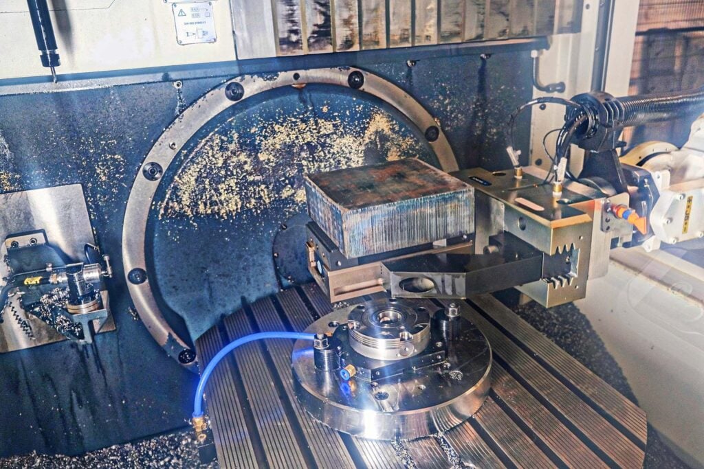

A bespoke robotic handling cell has been retrofitted to a DMG Mori 5-axis vertical machining centre (VMC) at the Redditch factory of Optimal Manufacturing, a contract machining company that was established in December 2022. Supplied by Whitehouse Machine Tools, the Tezmaksan CubeBOX is unusual for a 6-axis robot cell in that it is designed to exchange components mounted in vices on pallets, rather than the billets, castings or forgings themselves.
Joint owners and directors of Optimal, Will Cooper and Tom Slimm, decided to adopt this manner of automation, which requires a robot of 70 kg capacity, due to the frequent need to hold tolerances of less than 10 microns. In their opinion, it would not be possible to achieve the required level of repeatability if the individual components were to be handled, especially if they need to visit a turnover station prior to a second operation.
Instead, workpieces need to be fixtured in vices mounted on zero-point pallets that locate into a pneumatically actuated clamping station on the table of the DMG Mori CMX 70 U machining centre, one of two 5-axis models on site. In this instance, the workholding and location equipment was sourced from Ceratizit.

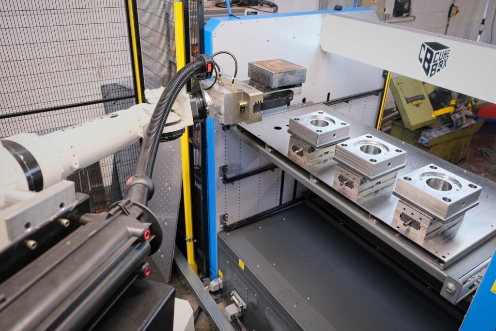

Tezmaksan, the Turkish manufacturer of the robotic machine tending cell, undertook major adjustments to the CubeBOX Blues DR MAX, one of the more heavy-duty plug-and-play configurations in its product portfolio. The three storage shelves, which would normally be stationary and holding unclamped workpieces, were fitted with motors and actuators so that they are able to slide horizontally towards the robot, and back again to facilitate manual loading and unloading of fixtured parts, four of which are stored on each shelf.
If the drawers were not able to move, the robot gripper would not have enough space to gain access to the two lower shelves to pick up any of the four vice-mounted billets, or return machined component afterwards. It is because the shelf separation is small relative to the nominal 300 mm cube profile of the payload.

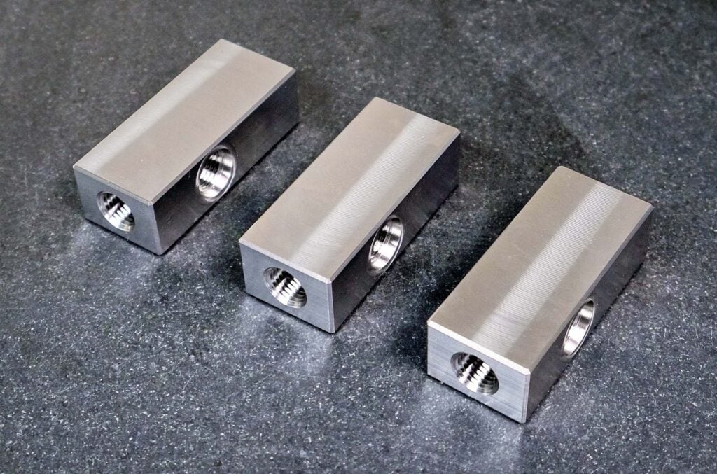

“Shortly after Brown & Holmes Automation had finished configuring the turnkey installation on behalf of Whitehouse, we received an order for a large quantity of stainless-steel valve manifolds from one of our oil and gas industry customers.
“It was ideal for automation and we ran the cell 24/7 for three months including over Christmas, unattended every night, allowing us to produce the parts economically while at the same time enhancing our reputation for short lead-time deliveries.”

For more open-tolerance machining, they decided six months after inauguration of the automated prismatic machining cell that it would be expedient to load and unload some raw material individually, rather than in the zero-point pallet-mounted vices. For this purpose, three thin plates were machined in-house and permanently mounted on each shelf. Large holes in the plates accommodate the zero-point locations and a grid of small holes drilled at 50 mm centres facilitate fixturing multiple components, typically up to 36 or perhaps even more.
As with all CubeBOX installations, the Blues DR MAX was supplied with Tezmaksan’s RoboCAM intelligent automation software, so there is no need for expensive third-party robot integrators. The system allows an operator without any robot programming experience to set up a new part in two to three minutes.
It is possible to load a DXF file directly, from which the software reads the part geometry and automatically calculates grip points and the positioning cycle. The system also tracks where workpieces are in real-time, enabling built-in collision protection. The software calculates and reports on cycle duration to establish production efficiency, including during lights-out manufacturing.
