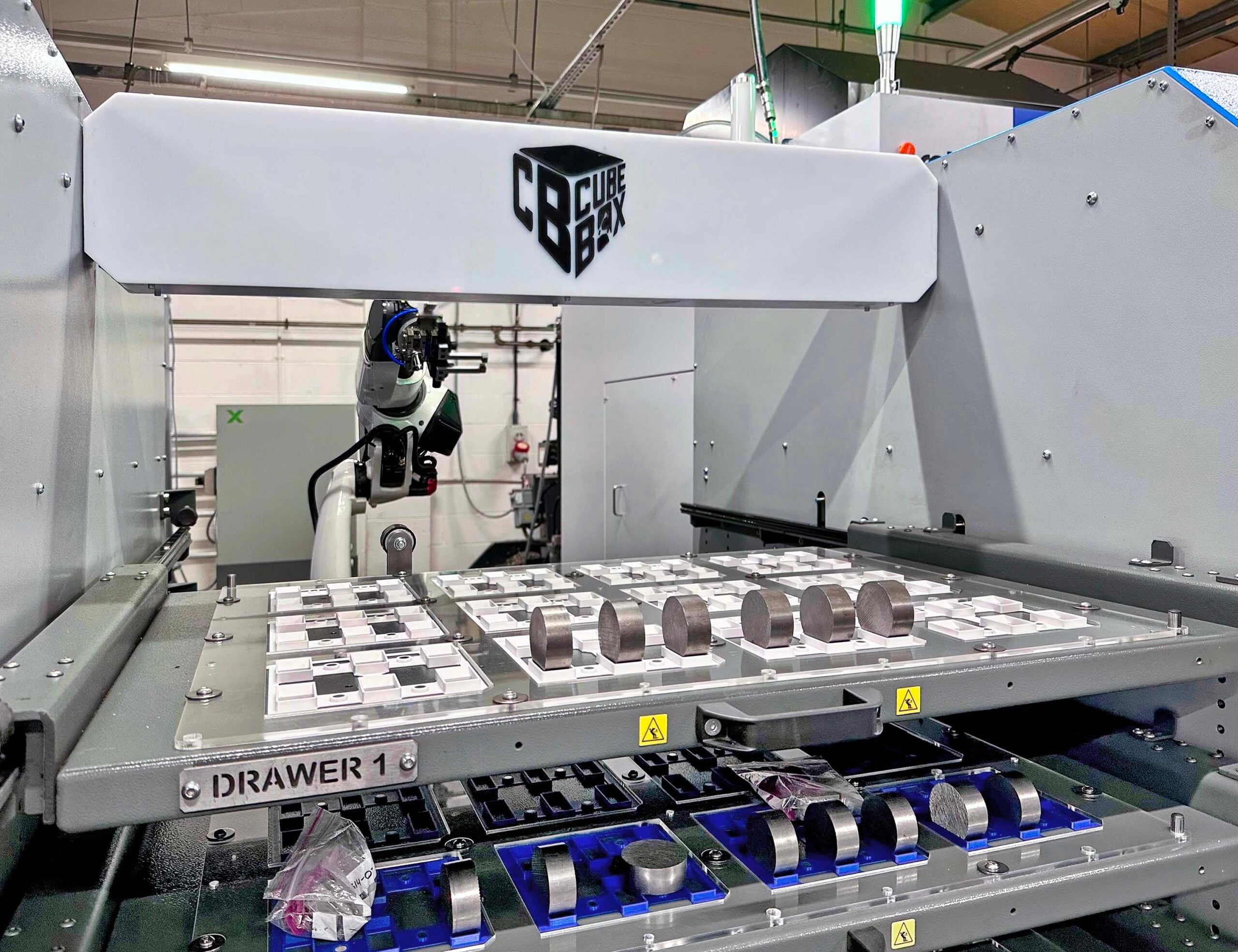

The first Brother Speedio proved so successful in terms of production output and accuracy, despite the tough materials being machined, that in April 2026 the subcontractor decided to install a second M200Xd1-5AX and automate both of them with a single workpiece handling robot. The Tezmaksan CubeBOX Blues DR is a compact automation system with a 6-axis industrial robot and an integrated storage unit consisting of a five-level drawer stacker.
The configuration in Leeds is engineered to handle round billets from 5 mm to 550 mm in diameter, having a maximum height of 135 mm and weighing up to 12 kg. The system facilitates 24-hour production including lights-out, with minimal operator attendance during daylight hours, boosting production output by up to 50%. Able to be installed in one day due to its standardised design, it offers a cost-effective alternative to bespoke automation and typically costs 20% less than machine-specific robot integrations.
A key advantage is the inclusion of the user-friendly RoboCAM smart automation software, which allows Kirkstall’s operators to convert 2D CAD drawings into robot instructions, without requiring robot programming or CAM knowledge. Manual unloading of machined workpieces and loading of fresh material for processing is accomplished while the robot continues to tend the two Brother machining centres. The system reduces human error, improves manufacturing quality and is expected to deliver a rapid return on investment.
