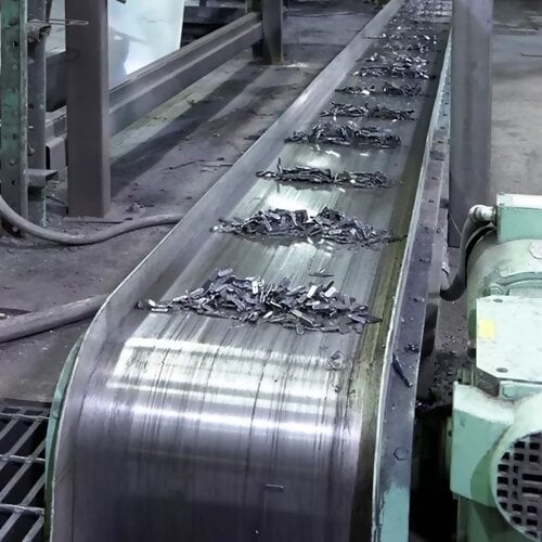

Eriez has introduced its Chip and Parts Conveyors, designed to provide safe, reliable, and efficient transport of ferrous materials such as chips, turnings, small parts, and stampings. The system stands out for its fully enclosed conveyor mechanism, which eliminates moving external parts that could jam, break, or create safety hazards for operators. With only an externally mounted drive motor, the conveyor remains entirely self-contained, ensuring durability and ease of use in demanding shop-floor environments.
At the heart of the conveyor system are permanent ceramic magnets housed within a liquid-tight, submersible casing. These magnets attract, hold, and move ferrous parts along the conveyor path, discharging them cleanly over the head end. This magnet-based mechanism provides a smooth and reliable transfer process while avoiding the need for exposed belts or chains.
The lower conveyor sections are designed to operate while fully submerged in coolant sumps or tanks, making them particularly useful in machining and stamping operations where fluids are present. The self-cleaning working face ensures that the conveyor remains efficient even under continuous operation, while excess fluids naturally drain back into the tank to reduce waste and support cleaner shop-floor practices.
The Chip and Parts Conveyors are constructed from a combination of steel and nonmagnetic stainless steel, providing both structural strength and resistance to corrosion. The slider plate and magnet assemblies are engineered to withstand the rigors of industrial use, ensuring long service life even in challenging environments. This robust design makes the conveyors well-suited for applications across machining, metalworking, and fabrication industries where the reliable handling of ferrous waste and components is critical.
By eliminating external moving parts, the Eriez conveyor enhances operator safety and minimizes maintenance requirements. Traditional conveyors with exposed belts or chains are susceptible to mechanical wear, potential jamming, and risks to nearby personnel. In contrast, the fully enclosed Eriez system reduces downtime, improves reliability, and creates a safer working environment.
The ability to submerge sections of the conveyor in coolant further extends its versatility. In machining centers, for example, ferrous chips often accumulate in coolant tanks, leading to potential blockages or reduced fluid quality. The Eriez conveyor provides a continuous and automated solution, efficiently removing these chips while allowing coolant to drain back into the system. This feature not only improves machine uptime but also supports better coolant management and overall process efficiency.
