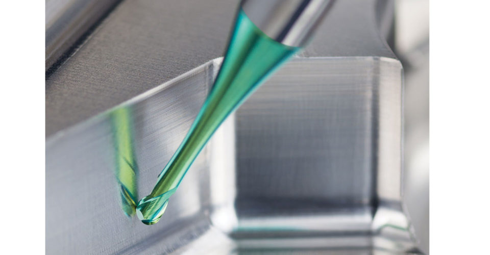

Micro end mills are small. Really small.
While no hard-and-fast definition exists to describe the size of these tools, a maximum diameter of around 2 to 3 mm is a good guideline. Quite often they are much smaller.
At this small scale, even the slightest incorrect tool movement, feed rate input, or depth-of-cut (DOC) selection can have disastrous results. The surface finish of a part or part feature easily is ruined, tools will wear prematurely or even break, and parts become scrap with just a single small error being made.
At such a small scale, every decision is big.
This type of tool commonly is used by manufacturers of parts in the medical, aerospace, and telecom sectors, and even in micro mouldmaking. Whether machining small part features or manufacturing small parts, required accuracies of 0.00254 mm are not uncommon.
