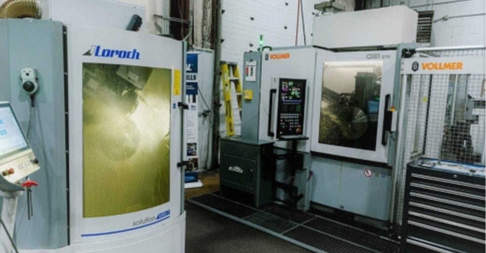

In 2018, Fastenal took the plunge and jumped straight into automation with the acquisition of a VOLLMER CHD270 carbide tipped saw sharpening machine with 8 CNC controlled axes and the VOLLMER ND230 automated loading station. With the capacity to store up to 250 saw blades, the 4-axis robotic loading system with three loading carriages transformed production almost instantly. As Mr Rodeghier continues: “The guys on the shop floor rapidly learned how to program and use the machine, and we soon got into a rhythm of re-sharpening and servicing special saw blades during the day shift and then loading-up standard geometry saws and batch-run quantities on the ND230 loading station for unmanned overnight running. Immediately, our team got into a cycle where we could process special saw blades by day, do standards and batch-runs overnight and, in the morning, we could unload the finished saws and pack them to be distributed nationwide back to our customers – and then start the cycle over.”
The benefits of the VOLLMER CHD270 in facilitating this production cycle has been significant. Firstly, despite having seven older machines, none were capable of processing special geometry saw blades. The special blades that were still serviced externally were instantly brought back in-house, giving Fastenal full process control whilst reducing lead times and dependency on an external supplier – and that’s before factoring in the elimination of subcontract costs.
From a productivity perspective, Fastenal stepped up from processing 25 TCT blades a day to over 25 on each shift – with the capacity to spare. As Mr Rodeghier continues: “Our extra capacity is created by several factors. Firstly, the CHD270 and its ND230 robotic loading system can process between 40 to 60 blades overnight unmanned, giving us cost-efficient production. Adding to this, the blade processing times are at least 35% faster than with the old machines. Furthermore, the automated wheel dressing and in-process measurement system that automatically probes and compensates for any grinding wheel dressing and saw blade geometry discrepancies takes another 15 to 20% off our setup and processing times. The probing cycle also picks up on any brazing errors or tooth issues to eradicate errors. When conducting this cycle unmanned, the CHD270 will identify the error, post an error message, return the blade to the automation station and continue its lights-out operation with the next saw blade. All this took us from 20+ blades a week to 20 blades per shift, equally important is that we can now sell this capacity which we were not confident to do previously.”
The instant success of the VOLLMER CHD270 resulted in the company ordering the Loroch Solution K850 grinding centre for sharpening, re-toothing and chamfering its metal-cutting circular saw blades. Delivered six months after the VOLLMER CHD270 in the spring of 2019, the combination of the Loroch Solution K850 and the VOLLMER CHD270 reduced labour requirement in the saw blade sharpening cell from five staff to just two – replacing seven machines with just the two. Alluding to this, Mr Rodeghier continues: “The two machines have saved us a huge amount of floor space, and we have reduced our headcount in the department, allowing us to re-locate skilled staff to alternate tasks. What we have also found is that we can now attract new staff, as people want to work on the very latest CNC technology that is available.”
Like the VOLLMER CHD270 before it, the arrival of the Loroch Solution K850 eliminated the requirement for external subcontract servicing of saw blades, giving Fastenal the flexibility, capability and capacity to produce both standard and special geometry blades. Despite being a manually loaded machine, the Solution K850 has more than doubled production from 20 blades a day to 20 per shift. “The Solution machine typically has a blade processing cycle time in the region of 12 minutes. This means we now have one operator working across both the automated VOLLMER CHD270 and the Solution machine,” said Rodeghier.
