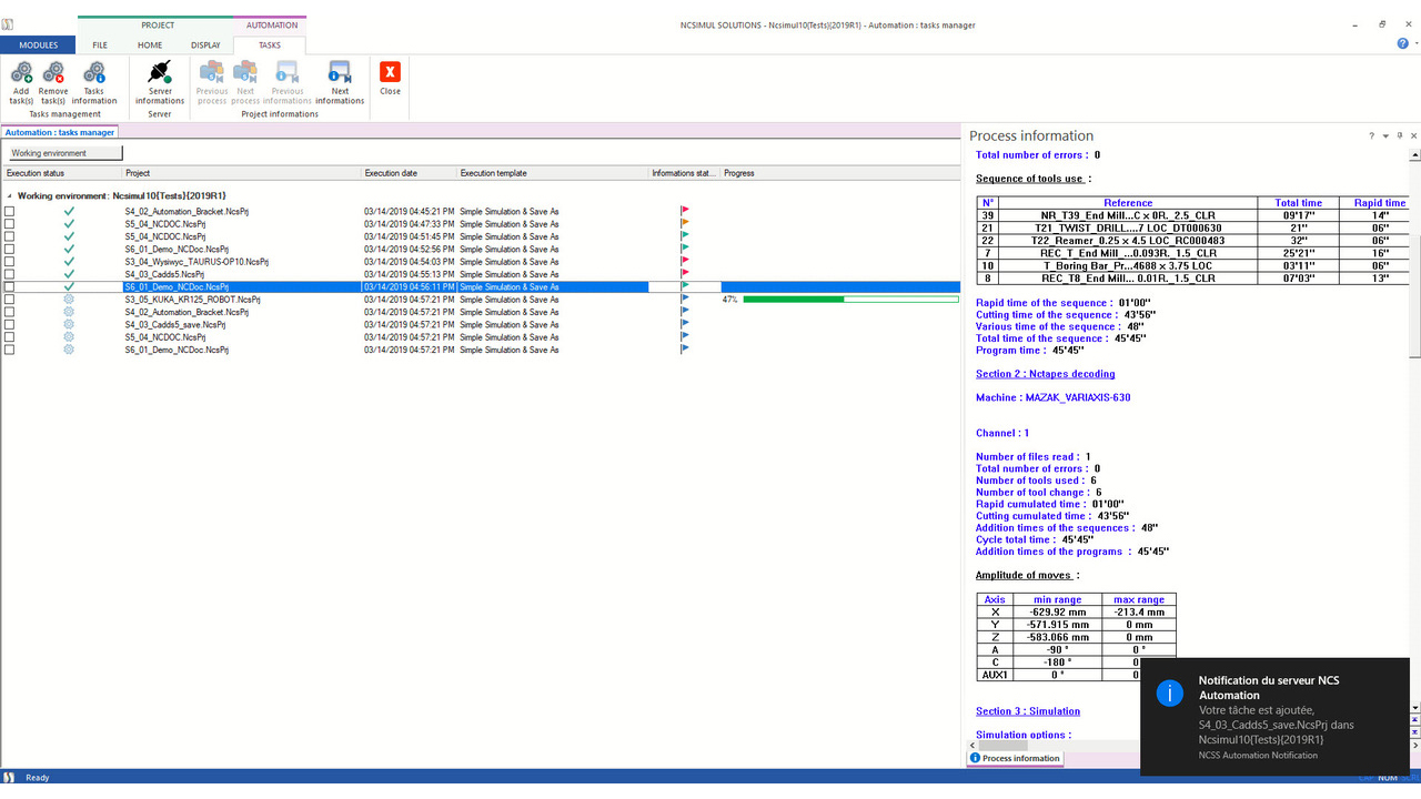

The latest CAM simulation software release from Hexagon Manufacturing Intelligence includes new and enhanced functionality giving users the ability to execute tasks for existing projects on a remote server.
Based on client/server scheduler architecture, the new  version of NCSIMUL’s machining module includes new automation functionality which gives the user wider control of their jobs on other devices, by communicating with distant servers.
Philippe Legoupi, NCSIMUL Technical Director, says a dedicated GUI allows tasks such as simulation, cut analysis and 3D movies to be performed on any device. “Users can follow the status of the job and receive a notification when it’s complete.”
The Automation Module provides a number of significant benefits, including a guarantee that a full 100 per cent of the program sent to the workshop is validated by the simulation. “For most minor modifications in the CAM, such as the number of passes, or changing the cutting conditions, the end user won’t verify the program because it’s too tedious – for example, starting the software, reloading the program and starting the simulation.”
The system enables customers to implement their own automation rules, according to constraints and production priorities. He adds that the tasks all feature in a command file, which also shows the parameters to use, and can be customised. It means customers can be sure that all program verification and simulation accurately follows requirements.
It also maximises license usage. For example, if a manufacturer has just one license, they can use this module to postpone tasks with the scheduler, until lunchtimes or overnight. “Companies with several licenses don’t need to use the scheduler at all – the server starts automatically when there are enough licenses for interactive sessions.

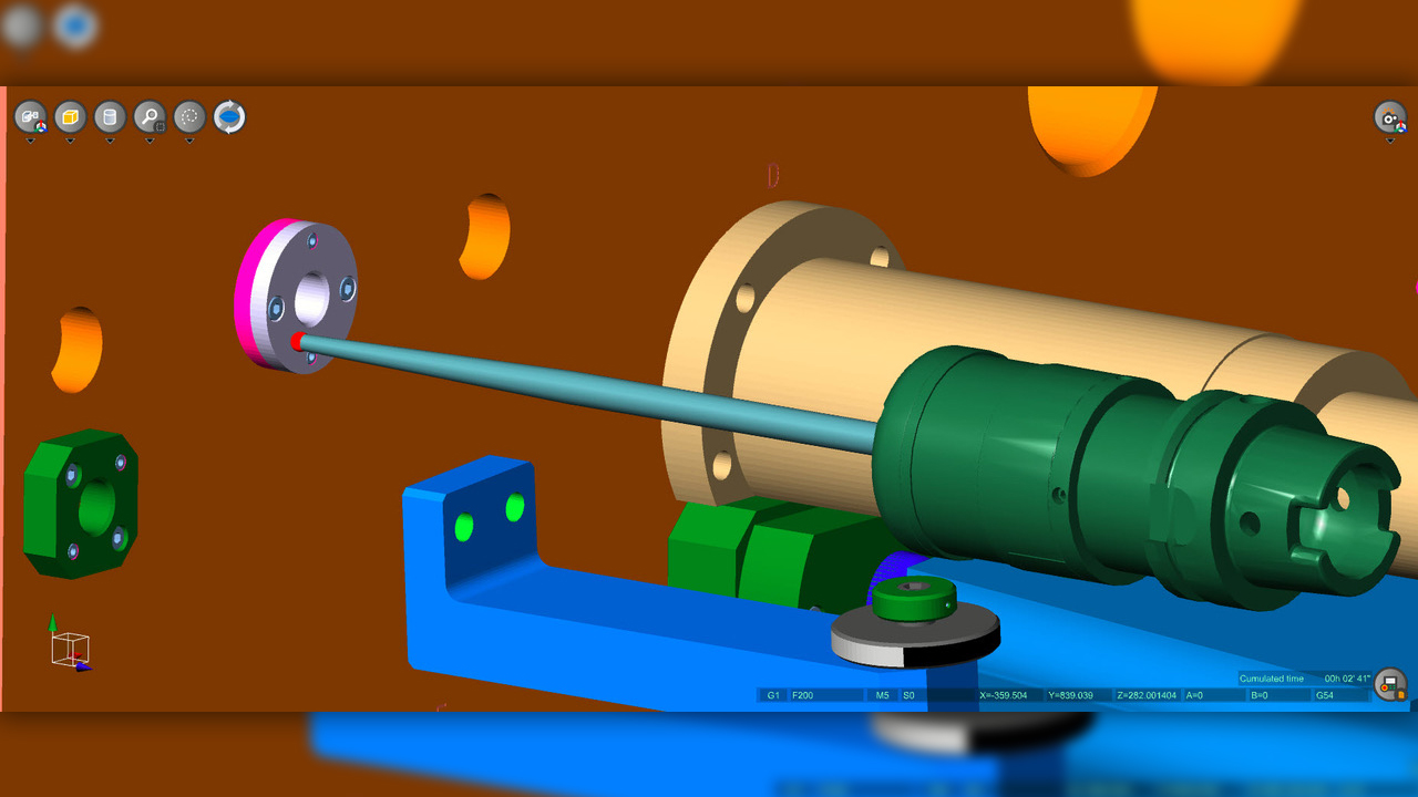

The high-end NCSIMUL MACHINE 2020.0 which detects NC programming errors and any potential collisions from the same NC code that drives the CNC machine, also contains enhancements to a variety of functions, including Probing and Optitool.
Probing: It is now possible to set specific simulation parameters for probing simulation during decoding. There is also the option to simplify the tool shape to reduce calculation times; default values can be defined into preferences; and interactive comments and ACNU functions can define any elements to ignore during the calculation of probing contact points.
