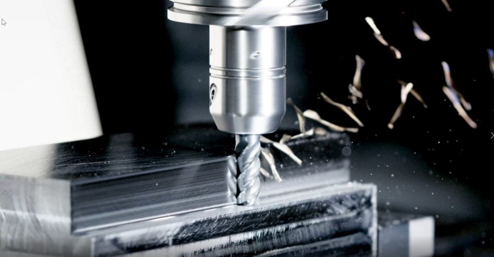

From its extensive milling portfolio, Guhring will be giving a MACH show debut to the impressive new RF100 Sharp Series of high-performance end mills – and this range will be put through its paces on the Grob to emphasise the performance characteristics of the end mills. Designed to address the issue of machining soft, tough and high-alloyed materials that create an issue with swarf clearance, the new RF100 Sharp Series is Guhring’s sharpest solid carbide milling tool to date.
The new RF100 Sharp demonstrates extremely smooth cutting action and chip removal and it is also an extremely flexible end mill suitable for slotting, ramping, roughing, helical milling, finishing and trochoidal cutting. The smooth cutting action combined with the potential to be used in a wide variety of applications makes the new RF100 Sharp, the end mill of choice on challenging material types.
