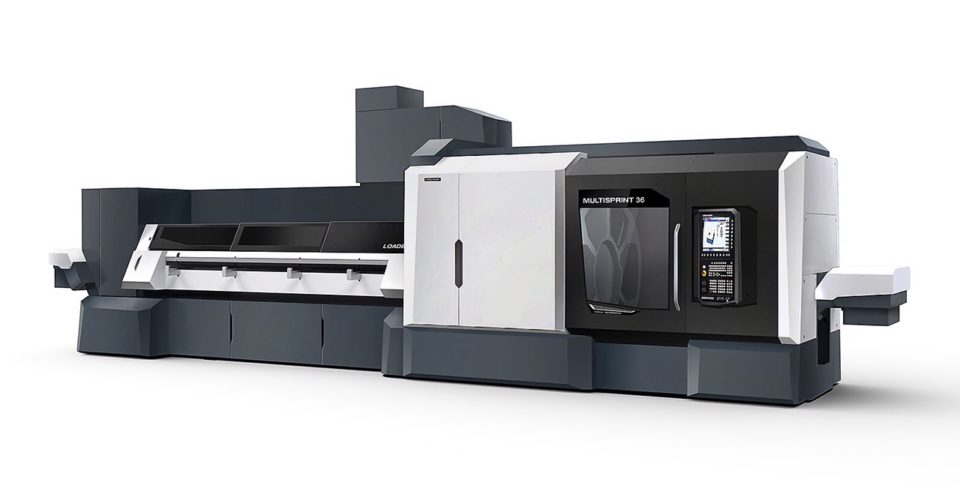

DMG MORI has combined the speed of multi-spindle automatic turn-milling with the versatility of sliding-headstock (Swiss-type) technology to launch two new machines with up to 41 CNC axes at this year’s EMO machine tool show in Hannover (18th – 23rd September 2017). The multis are manufactured at the group’s recently remodernised Gildemeister Italiana factory in Brembate di Sopra, which has experience of delivering more than 5,000 fixed-head multi-spindle autos.
In a compact footprint of 21.9 m² including proprietary bar magazine and high pressure coolant system, the MULTISPRINT 25 and MULTISPRINT 36 are capable of manufacturing components from bar up to 25 mm and 36 mm diameter respectively. The larger machine can also turn chuck parts up to 50 mm diameter, a process that can be automated by one or two robots in the working area.
Driven tools and a 100 mm Y-axis on the cross-slides at each of the six spindle positions allow highly complex workpieces to be completely machined with up to 28 standard tools, 24 of which may be driven. X-axis travel is 50 mm and Z-axis travel is 100 mm, or 180 mm in combination with DMG MORI’s SWISSTYPEkit including driven guide bush. Converting the lathes for long part turning takes less than two hours. Maximum rotational speed of the spindles is 7,500 rpm, while driven tools rated at 13,800 rpm / 14.2 Nm provide considerable versatility of production.
For rear machining, MULTISPRINT machines can be optionally equipped with a pick-up spindle or one or two counter spindles, allowing cycle time reductions of up to 35 percent through one-hit production. The pick-up spindle moves 230 mm along the Z-axis. The counter spindles, which index in 0.002-degree increments, move 280 mm in X, 320 mm in Y and 370 mm in Z. Machining is completed using a double endworking station with three driven and two fixed tools. Control is provided by a Fanuc series 30i.
