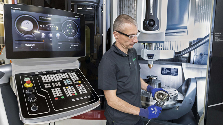

The German group Schaeffler Technologies, which manufactures roller bearings for automotive, aerospace and industrial applications and owns the INA and FAG brands amongst others, has entered into a cooperation project with global machine tool manufacturer DMG Mori. They are testing suitable metals to advance the development of additively manufactured roller bearing components with the aim of realising optimised products that offer greater added value for end customers.
Since May 2017, Schaeffler has been using a DMG Mori LASERTEC 65 3D hybrid machine to produce one-offs and small batches of bearing components as well as spare parts in metallic functionally graded materials (FGM) to finished part quality. The rapid, one-hit process combines the flexibility of additive manufacturing by laser deposition welding with 5-axis subtractive milling.
Schaeffler was not new to generative manufacturing, as it already used 3D powder bed printers for making plastic prototypes and fixtures and for small series production.
The LASERTEC 65 3D hybrid is equipped with a twin powder feed that allows changeover from deposition of one material to another. It results in a smooth transition between materials with different properties. The toughness and hardness of the material can be regulated during the build and optimally tailored to the specific requirements of each application.
