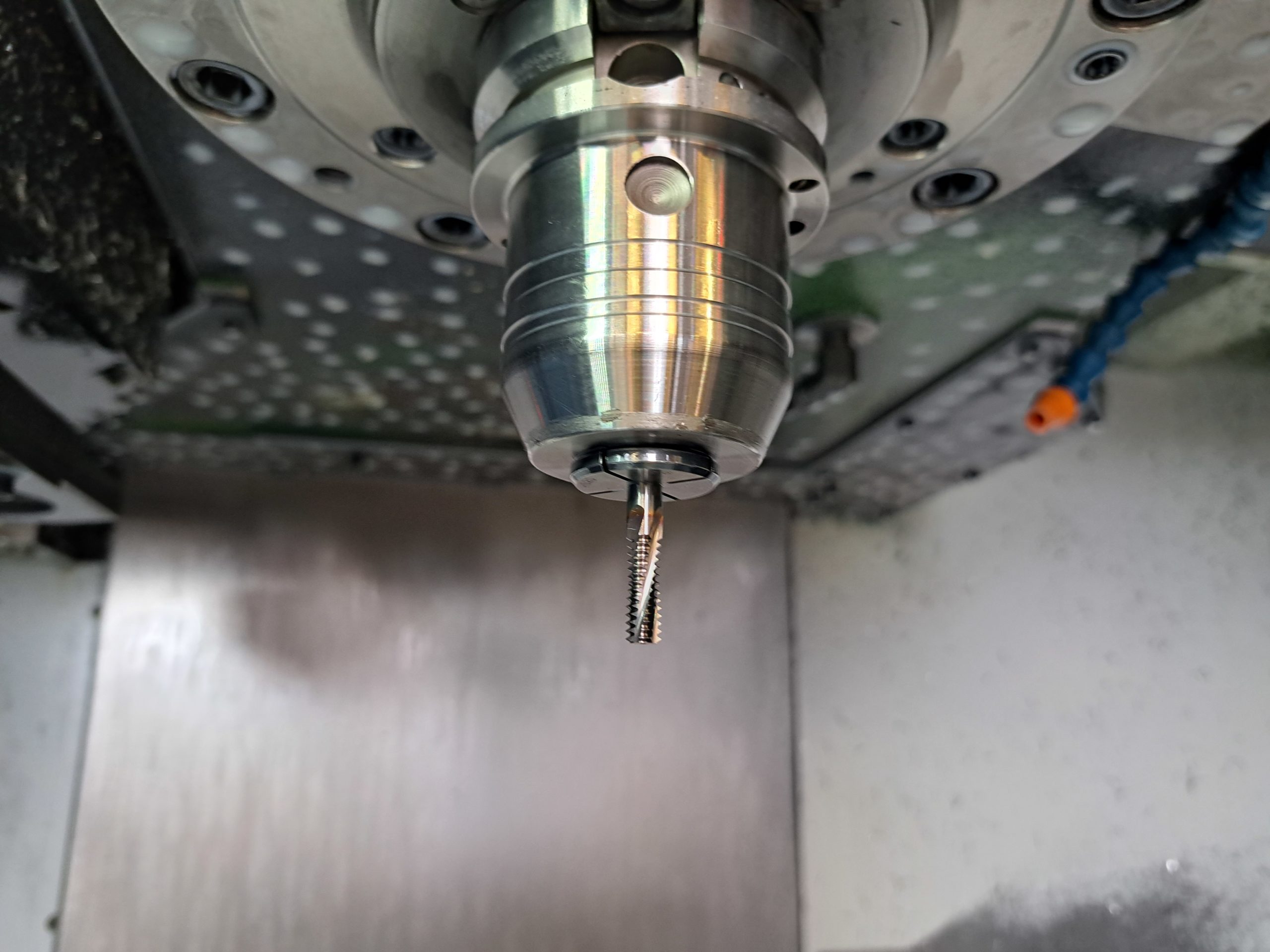

Looking at threading applications in the milling department, Steve Elliot from IPEL says: “I think the main headaches are threading operations and putting taps into parts, we do a lot of stainless and exotic materials. In the past, using taps could be risky on these materials, particularly when they are low volume high-value parts. We don’t have any facilities in the house to remove broken taps, so we would probably have to end up subbing it out to someone to get it wire eroded out. This is a lot of cost and there is a lot of added lead time to that, which is what we are trying to avoid.”
With this scenario being a common occurrence for subcontract manufacturers, IPEL moved many processes to thread milling. On one specific part that had 18 threaded holes, IPEL converted to a Vargus threading process from a standard process, Steve explains: “On this part, we were starting to use thread mills as opposed to tapping, but it was increasing the cycle time. I spoke to the guys at Vargus and they recommended their new Mach TM tool. It immediately reduced the cycle time significantly. We have gone from about 10 seconds a hole down to 2 seconds a hole. This is all completed in 1 pass, so we are winning all round. In the tooling trails, the tool life is looking great as well.”
Discussing the thread milling process, Paul Smith from Vargus says: “We applied the Mach TM system and managed to drop from 10 seconds to 2 per thread with just one pass instead of two. The operator was blown away.”
