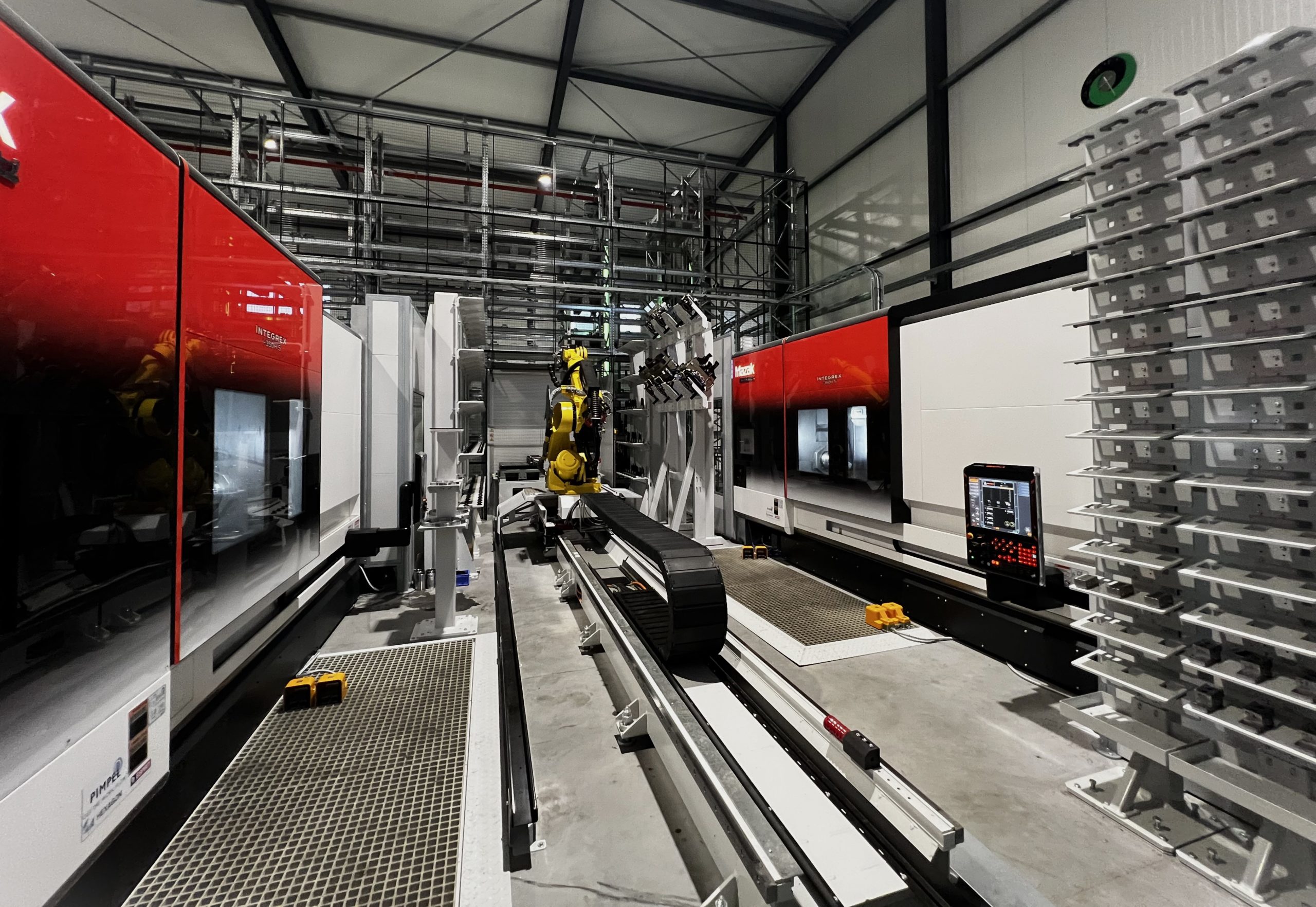

On the opposite side of the FASTEMS AMS is a two-machine turning cell with Integrex i-350H S turning centres supported by a FANUC robot. Configured slightly differently from the milling cell, the robot runs between the two machines loading/unloading components, cutting tools, interchangeable chuck jaws as well as its different gripper configurations to produce a wide array of parts. The cell will also automatically machine soft jaws to accommodate pending jobs.
