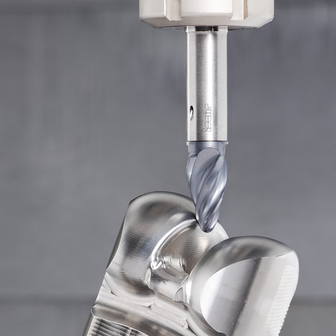

When machining with carbide endmills and exchangeable heads, grade IC902, which combines ultra-fine grain substrate and nano-layer PVD TiAlN coating, ensures extremely high wear resistance and prolongs tool life. This demonstrates good results in producing devices for replacement knee and hip joints from cobalt-chrome alloys (Fig. 1).
