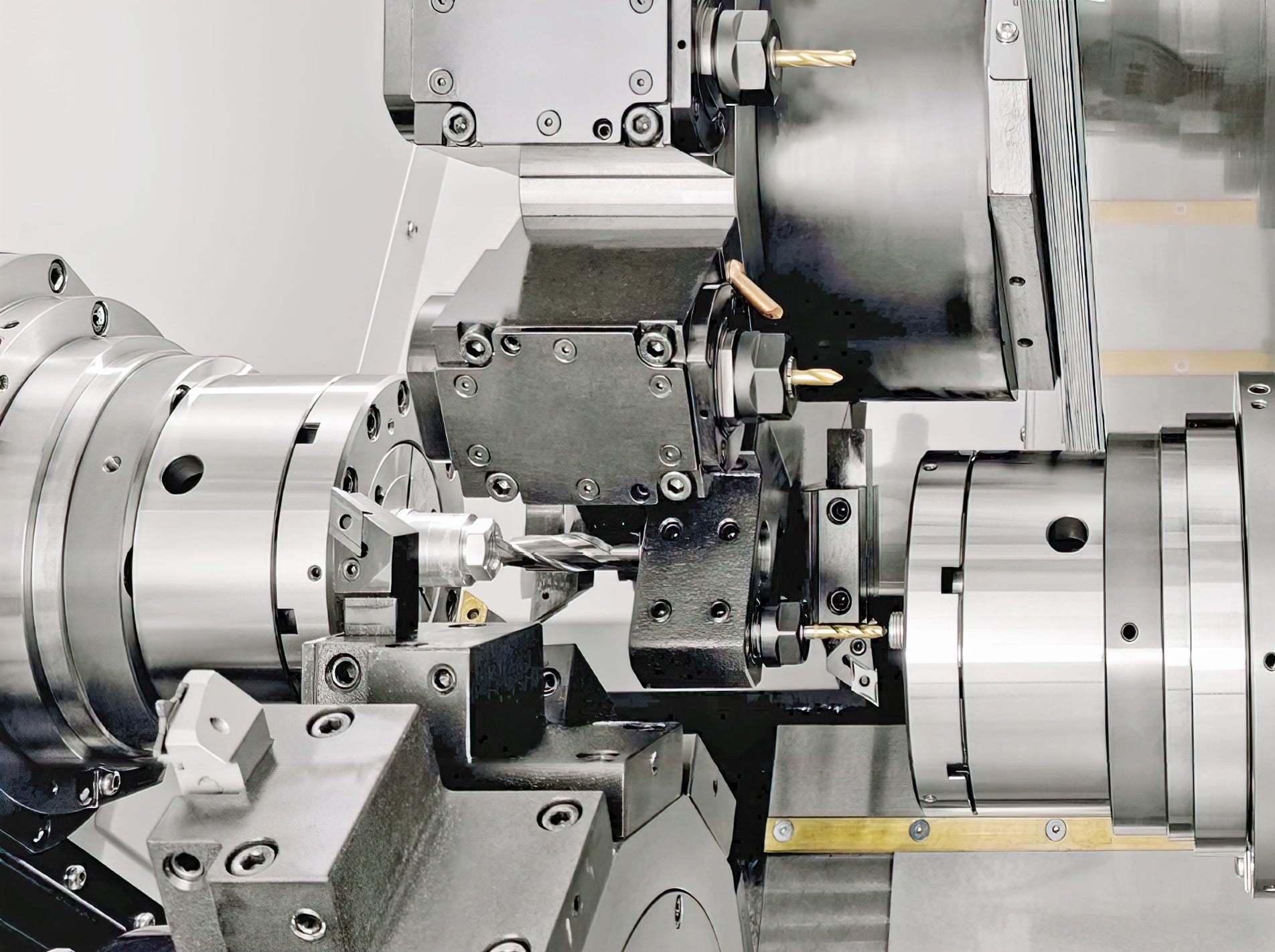

The fixed-head Miyano lathes produce parts from bar ranging from 8 to 65mm diameter, or from billet up to 200mm diameter. They started arriving in 2012 with a pair of 42mm bar capacity BNA-42MSY turning centres for complex turn-milled components in the oil and gas sector. Latest to be installed, in July 2025, was a Miyano BNE-51MSY. Three new lathes from Citizen arrived on the shop floor in the first seven months of 2025.
The BNE-51MSY was preceded in 2022 by a BNE-65MYY, extending component diameter capacity to 65mm. The lathe has Y-axis movement on both tool turrets, enabling efficient production of an aircraft component in one hit using superimposed machining with three tools in cut simultaneously. Central to operations is a well-equipped inspection room. Quality assurance begins before production with thorough review of technical drawings, continuing throughout with first-off and in-process inspections using touch-probe and optical measuring equipment. Everything is traceable from raw material receipt through to despatch.

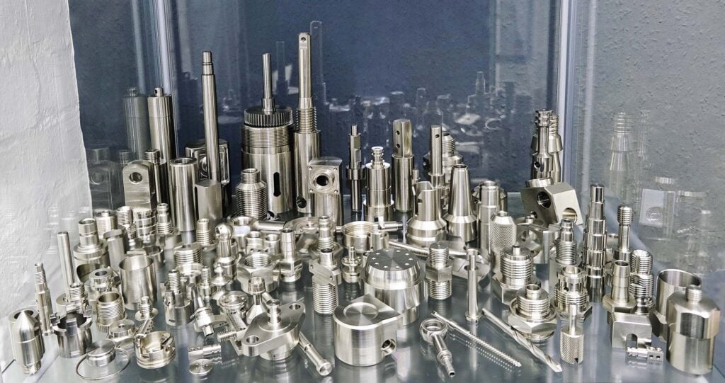

Sub-CNC specialises in high-volume turned parts production. Recent contracts include 20,000 stainless steel automotive components weekly, 3,000 complex sensor parts weekly for utilities, and five brass components for oil and gas totalling 10,000 monthly. The subcontractor also undertakes design and prototyping followed by short runs of 10 to 20 off, often turning into long-running contracts.
