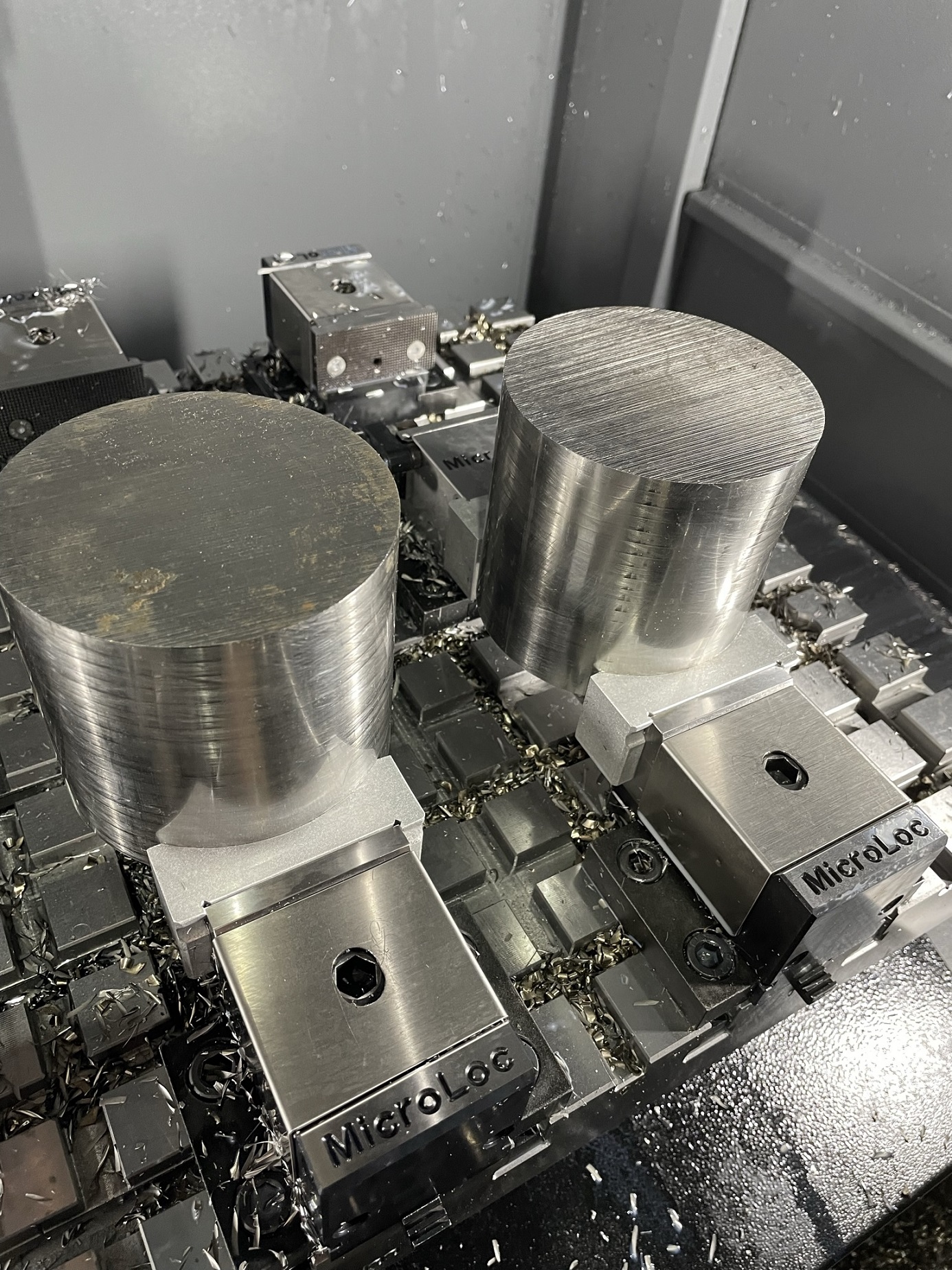

With demand for regular batches of 50 to 100-off parts for a prominent company, AXI5 was having issues with its cutting tool performance. With the project expected to be an ongoing regular commitment from the customer – a solution was needed. So, AXI5 called upon ITC to solve the problem. On its compact Hurco VMC, the Warwickshire manufacturer set up two Microloc clamping systems to machine 100mm diameter billets that are 92mm long. The set-up was clamping on 15mm of stock with a bar protrusion of 77mm.
Despite the robust performance of the Microloc system, rough machining a square profile in the round billets created excessive noise and didn’t give the AXI5 team the confidence to leave the machine to run through its cycle. As well as creating excessive noise, the 25mm diameter indexable end mill was also providing limited tool life and poor material removal rates. Investigating the process, ITC’s Simon Yeomans recommended the Widia VXF high-feed 52mm diameter face mill with five insert seats for the rough machining of the parts.
With two parts clamped on the machine and milled in a single operation, the previous cycle time with a rival tool was 15 minutes, something that ITC rapidly cut to just under nine minutes – a 40% cycle time-saving. This was achieved by executing cutting parameters of 163m/min with 0.75fz and 0.8ap with a ramp angle of 0.7°. The result was that the 15-5PH stainless steel parts that had been annealed to BM9050 and were proving a particular challenge, one that had been overcome by ITC with a significant productivity increase.
The key challenge for AXI5 was having the confidence to walk away from a process that was creating excessive noise. Thankfully, the smooth cutting action of the Widia VXF high-feed face mill eliminated excessive noise and chatter and gave the small business confidence to allow the machine to run unattended. The impressive cutting characteristics of the ITC Widia VXF tool also delivered reduced costs and prolonged tool life.
With two parts clamped in the work envelope simultaneously, AXI5 could only machine four parts before an insert change was required with the previous tool. However, the ITC Widia VXF could machine three batches of parts as opposed to two – 6 parts instead of 4. This impressive performance on a particularly difficult material equated to one hour of machining time for each insert edge with the Widia VXF face mill. Equally impressive is the ability of the new ITC Widia tool to reduce costs for the business. On a run of just 600 parts, ITC is expected to save AXI5 over £4000 – or £6.60 per part.
