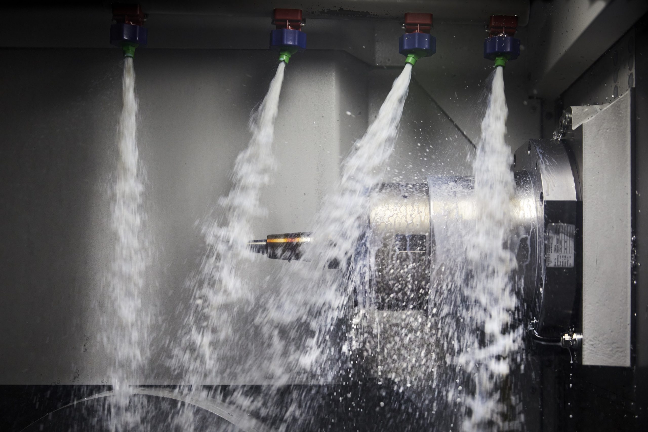

The AMRC houses an array of equipment to enable partner companies and project sponsors to develop and trial new technologies and processes. The AMRC works closely with customers and project sponsors to select the ideal machines and technologies required to fulfil each project’s individual demands. Initiated by the AMRC’s Machining Group with two of its Tier 2 partners, Starrag UK and tooling integrator, NIKKEN, Starrag’s Heckert X40 horizontal machining centre has been moved a few hundred yards from its initial AMRC Factory of the Future base on Sheffield’s Advanced Manufacturing Park to NIKKEN’s Innovation Centre. Engineers from the AMRC team are continually working with NIKKEN and Starrag to utilise the capabilities of the 5-axis machine and its tooling packages.
The features of the Heckert X40 include rigidity and damping, based on established and renowned build principles. This is complemented by rapid traverse rates of 80m/min and a 20,000rev/min spindle that offers torque values up to 350Nm. Among NIKKEN’s tool holding solutions is the Slim Chuck, a high-accuracy collet chuck that boasts a minimal runout of 3 microns at 4XD. This leads to higher component precision and improved tool life. The Slim Chuck has a maximum gripping torque of more than double that of traditional ER alternatives. This complements the Heckert X40’s rigidity and stability, permitting more aggressive machining parameters. This also improves process security and leads to reduced scrap, especially on titanium and aluminium workpieces that fit in the envelope of 700 by 750 by 750mm.
Mr McCready adds: “With all three partners collaborating, we have collectively achieved some incredibly successful results by pushing the limits of the machine and the tooling. This has been achieved without jeopardising the quality of workpieces. Importantly, we closely monitor and record the performance data in real-time relative to NC code lines via digital connectivity through a Siemens Edge device. The machine incorporates Starrag’s human-machine interface (HMI) for easier, more intuitive programming and operation. This includes factors like machining forces and spindle temperatures. We interpret this data and, if necessary, adjust the processes to suit and ultimately arrive at an improved NC code to achieve consistently repeatable process improvements by setting new machining benchmarks.”
