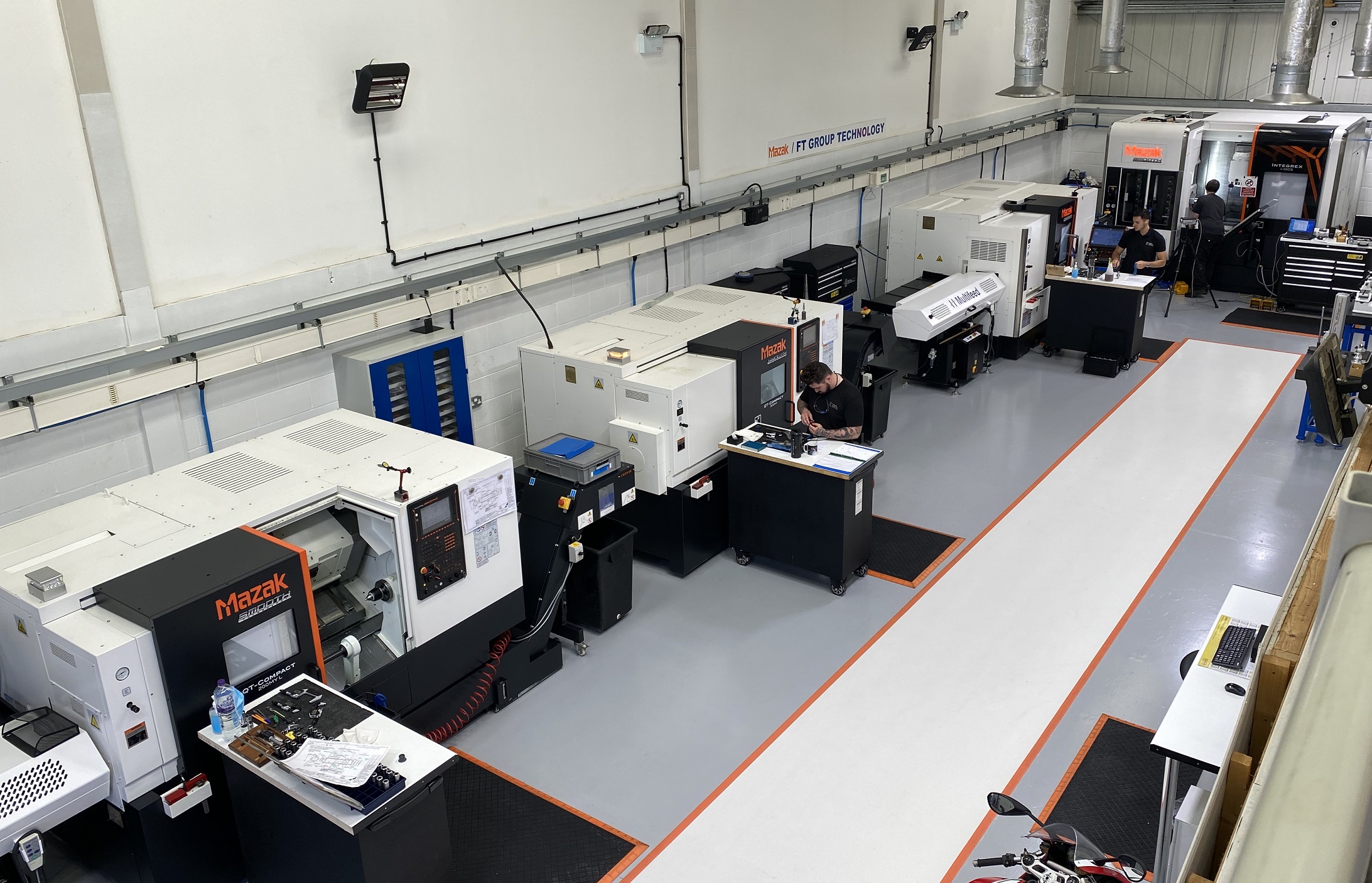

On the first visit, Jason and the MTD team went to FT Gearing Systems Ltd in Aldershot, a manufacturer of precision machined components and gear technology solutions for the aerospace and defence industry. The company has a complete suite of Mazak machine tools and upon arrival, a Mazak engineer was installing the company’s latest acquisition, an Integrex i-100S. The new Integrex i-100S is adding to a plant list that already includes a Mazak Integrex i200s, three Integrex i200, a QT10n Smart 200, a QT10N MY, two 300MY machines, a 200MY plus others – a journey that started back in 1998.
