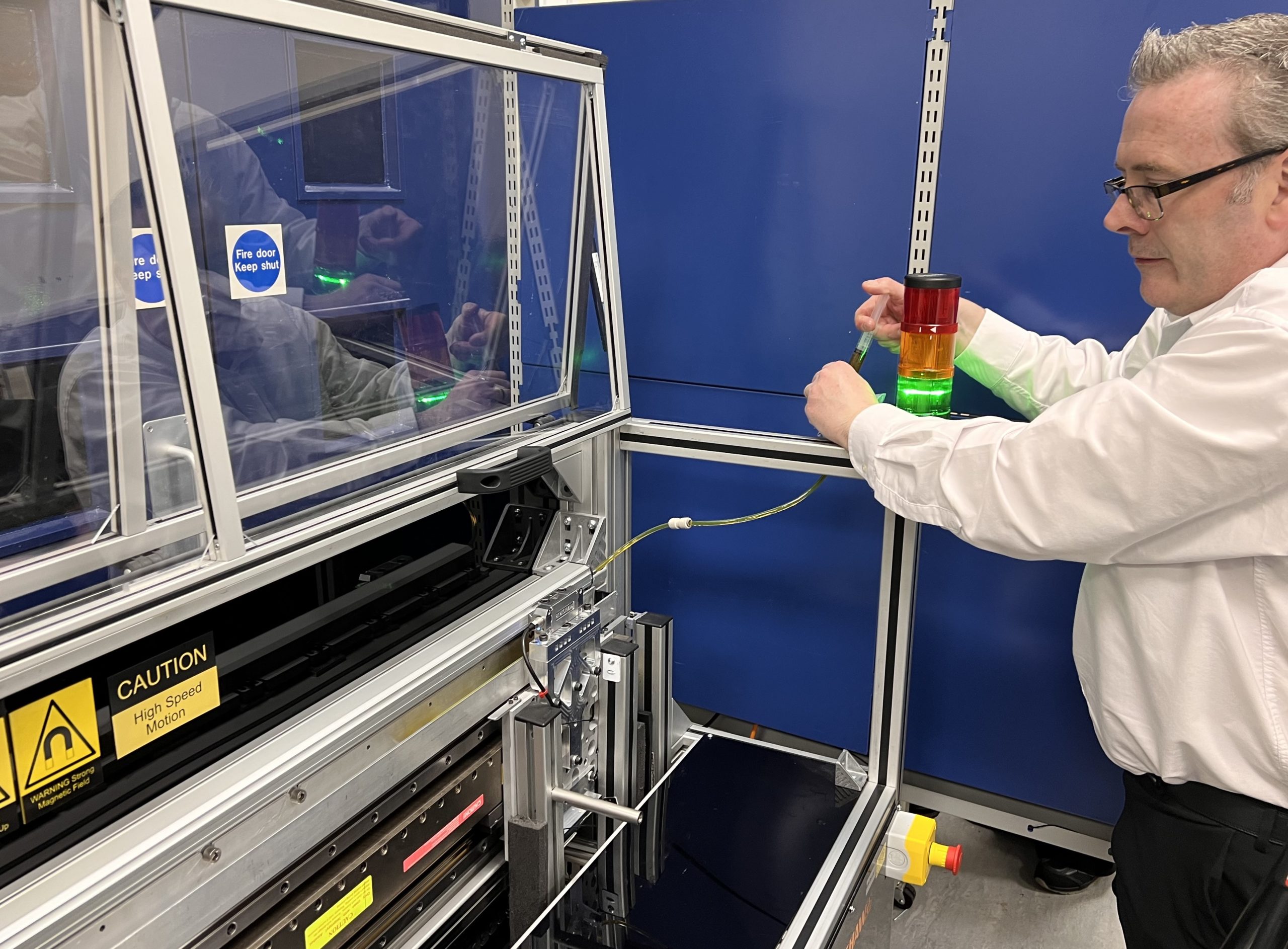

To address the pain point of installing enclosed encoders, Renishaw designed the system so that specialist knowledge, tools or equipment are not required to install the FORTiS encoder. Renishaw’s patented readhead set-up LED and ADTa-100 Advanced Diagnostic Tool, which provides a user-friendly display of advanced encoder diagnostic information, ensure intuitive and right-first-time installation. During our visit, the MTD team managed to install a FORTiS encoder on a test rig in 45 seconds – the current record is held by an engineer who installed a FORTiS encoder at the IMTS exhibition in just 13 seconds! To do this on a working machine tool and including the time taken to access the linear axis, Renishaw estimates that an encoder can still be installed in less than 15 minutes.
Not only are the encoders designed to be simple to install, but Renishaw has also introduced its patented LED system that indicates signal strength. So, a blue LED showing maximum signal strength will confirm the correct alignment of the encoder’s body and readhead whilst an axis is traversed. This reduces the skill requirement and mitigates the risk of rework or unplanned machine downtime caused by incorrectly installed encoders. As Corrie says: “The installation technique we developed means that FORTiS encoders self-align with the transit brackets. This is advantageous when it is first installed on the machine builder’s production line, or at the machine dealer’s facility. It also helps throughout the lifetime of the machine tool as it removes the need for technician-level skills and tools, which are often in short supply. For example, you do not need to use a dial gauge with the FORTiS encoder, although you can if you wish, as we have built that into the system. We have made it so simple that if everything is done right, the LED turns blue, indicating that the job is done correctly. Equally, it also tells you when it has been done incorrectly.”
