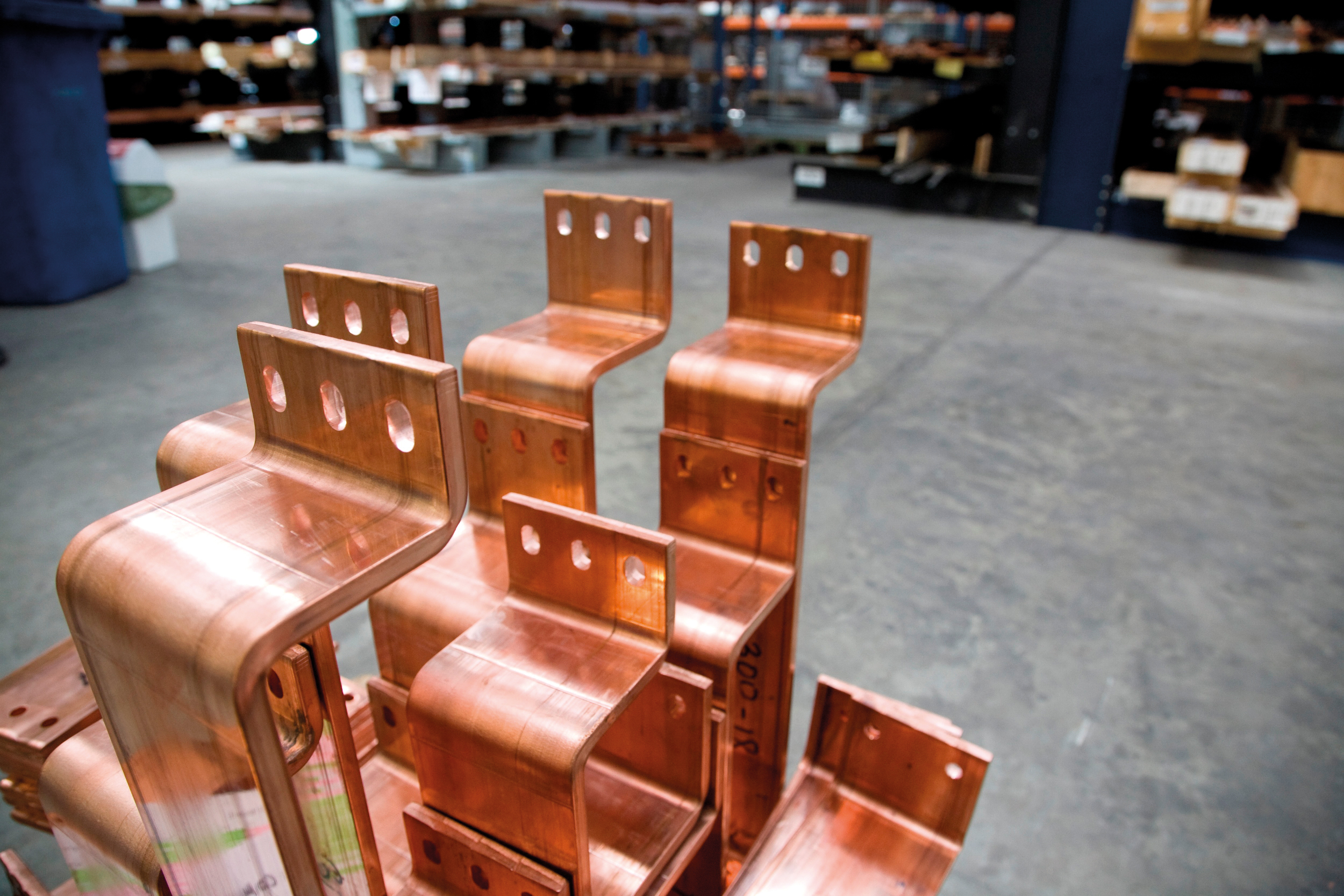

Customers include companies across the spectrum of electric vehicles such as tier one and tier two suppliers of big-name car marques; supercar manufacturers; supercar e-racing; electric motorbike GP racing throughout Europe; railways; aerospace and increasingly electric buses, construction and agricultural vehicles. For the battery, the Kent-based company makes a wide range of customer-specified busbars that form part of the electrical connection, along with modular busbars that connect the battery to the rest of the vehicle’s configuration.

The company uses Radbend to calculate bend angles and the order of bends for forming the busbars into a variety of configurations.
