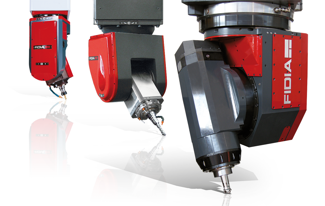

The most common way to do this is by introducing bi-axis or 5-axis heads. These portal milling machines can be categorised in many different ways, but I’d like to divide them into three main groups simply using their size. Small Portal, Medium Portal and Large Portal

In the automotive industry, medium size portals are used for mould and die applications. Most aircraft bodies are milled with this range of portal machine. In the oil and gas industry, they are used for valve and pipe machining. Generally, these machines are expensive, therefore the purchaser of this type of machine would require additional flexibility for multiple applications. This is the reason we would often install multiple heads and an additional carousel type rotary table to give a diversity of machining options. For example, by having a carousel table and a turning tool head that can be replaced along with the main spindle, the ability to use the machine like a vertical lathe is then possible.
In addition to a vertical milling head, a horizontal milling head, a 5-axis head, a grinding head and perhaps even a long-nosed vertical head can be added. Some well-known companies that manufacture this type of machine are Fidia, Breton, Promac, F.P.T, Parpas, Fives, DMG MORI, F-Zimmermann, Soraluce, Correa, Zayer, Unisign, Ken and Okuma. This size of portal is usually sold using a linear guideway moving system. The propelling mechanism is usually a rack & pinion with a dual servo motor for backlash elimination, but ball screws can also be found in machines of this size. In recent years, linear motors are being used for HSM to provide higher accuracy and better longevity.
