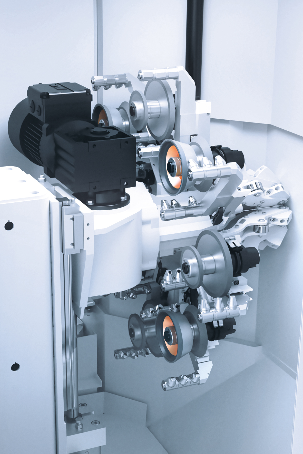

To produce 100% of the tools that I encounter daily, the VGrind 340S not only delivers productivity, technology and process stability – running through the very DNA of the machine is a high level of flexibility. The VGrind is the only machine to incorporate multi-level machining with two spindles located on its A-axis. Feeding this paradigm leap in innovation is a grinding wheel package that accommodates up to 8 wheel sets. With 8 different wheelsets, the VGrind 340S can automatically change from a flute grinding wheel to a gashing wheel, cup wheel, a 1A1 wheel for relief and OD grinding or any other type of wheel.
This enables the VGrind 340S to produce a variety of cutting tools with zero manual intervention. With in-process grinding wheel probing and automated wheel dressing; long periods of precision lights-out production can be achieved – regardless of the multiple tool types required. The flexibility of the VGrind 340S is complemented by the next-generation V@DISON IoT digital solutions and the NUMROTO tool grinding software to enable customers to stretch their imagination with cutting tool design.
