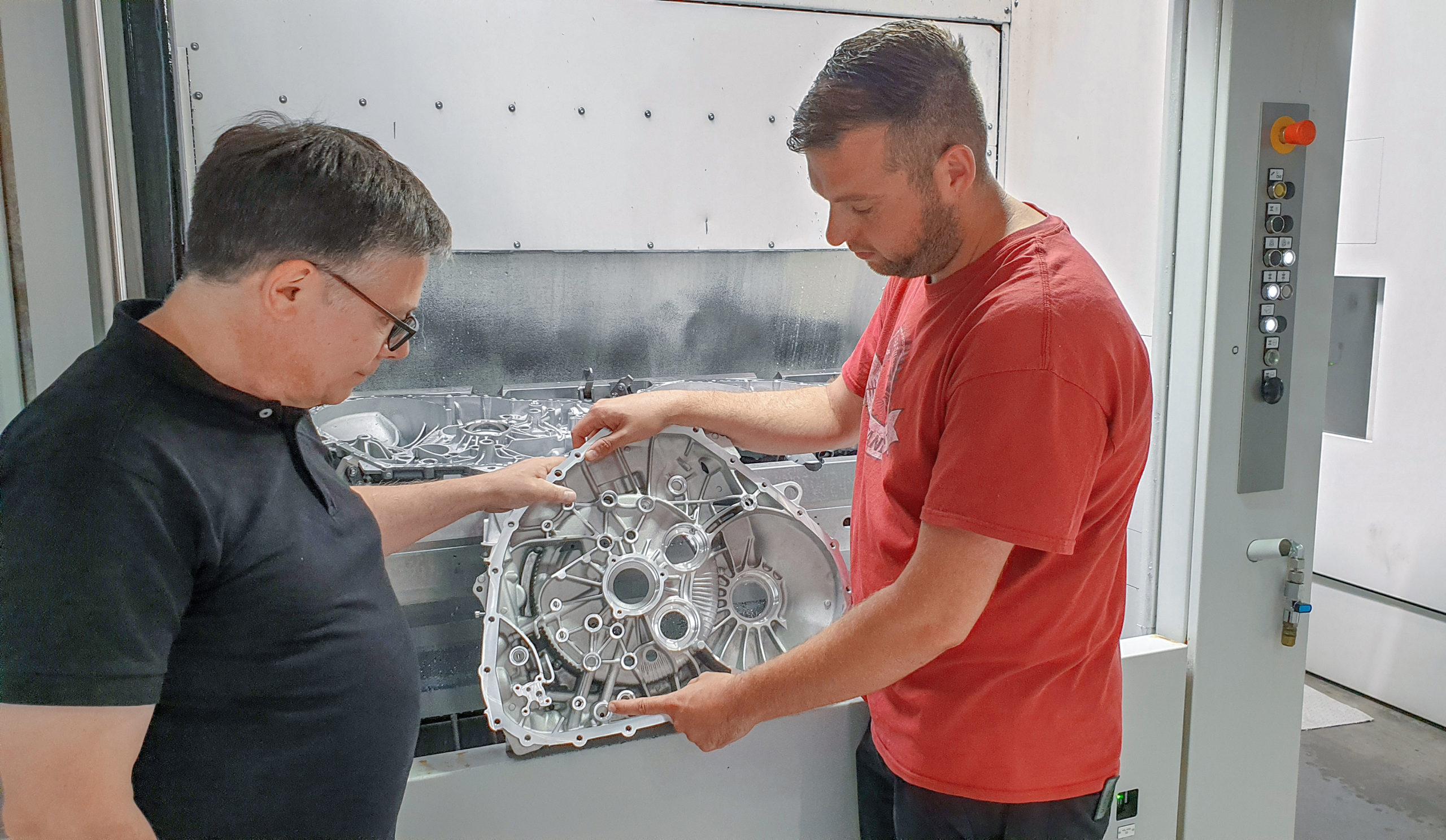

“The part is not only an adapter flange, but also the back of the transmission. The bearing seat thus requires the highest degree of precision”, explains Sebastian Swiniarski, Work Preparation Team Lead at Schlote. The part requires many bores with different tolerances.

When it came to optimising the deep bore, Plant Manager Tino Lucius, a former MAPAL employee, suggested PCD variants. And so, the partners developed the idea of deploying a PCD tip for the deep-hole drills. There was a lot to consider during the implementation, Frick relates: “It is not possible to construct this type of drill entirely out of PCD. Besides the high costs, the brittleness of the material is a problem. There is also always the danger of chipping off the cutting edges during interrupted cuts. Good cooling must also be ensured as PCD is heat sensitive.”
For the new tool, MAPAL started with the existing solid carbide drill and inserted a PCD cutting edge at its tip. The structure of the tool is reminiscent of a concrete drill with a carbide tip. The manufacturers in Harzgerode are very happy with the PCD deep-hole drill’s tool life. While the solid carbide drill’s tool life ends after 2,500 parts, the PCD version keeps going reliably up to 15,000 parts. There is further scope for improvement in machining challenges, such as blowholes in the material and varying casting quality. The partners are currently working on this together. “We have occasionally been able to achieve a tool life of 40,000 parts. Naturally, we want to make this ultra-long tool life the norm,” Frick stresses.
The cutting data is the same as that of the solid carbide drill at a spindle speed of 8,700rpm, a feed of 0.3mm/rev and a cutting speed of 218m/min. The new drill’s potential lies in its considerably longer tool life, the resulting lower tool costs and the higher process reliability. Fewer tool changes also mean less machine downtime.
