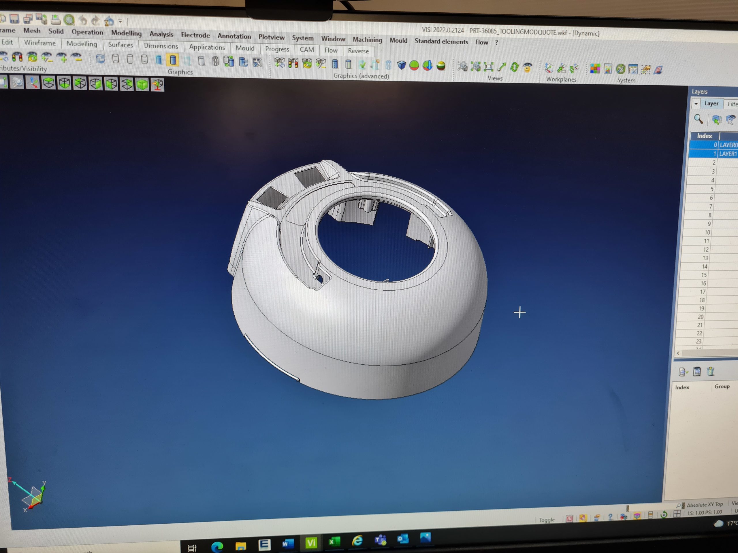

The toolroom at Numatic has 11 staff and a selection of CNC machine tools from XYZ, Hurco, HAAS, YMT and Sodick that are all utilised for machining inserts, punches and any other wear parts or components that may need repair or replacement in the mould tools that are running around the clock. Numatic has more than 2100 injection mould tools on-site and at any point, the toolroom could be called upon to remove damaged or worn components from a mould tool, locate the drawing file and subsequently create a CAM file with VISI and then machine a new component for the tool. Once this task is undertaken, the tool is returned to the production line.
The injection moulding machines on the production floor range from 40 to 1400 tonne pressure machines with the largest injection mould tool weighing in at 15 tonnes. Working in such a demanding environment, the majority of components in the injection mould tools are produced from 40HRc steel, which provides added challenges for the toolroom that is tasked with machining the components.
Scott continues: “For the high-volume injection moulding machines, we always have a spare injection tool in place and ready to go, but for the lower volume parts, we have to leap into action and apply VISI to create a CAM file from the XT ParaSolid drawings that we have on our tool registry files. From this, we generate the most productive machining strategy for our machine tools, proving out the process and getting the parts machined quickly. As the material is difficult to machine, VISI helps us with our machining strategies to account for this. We would be completely lost without VISI as it allows us to load particular programs into our machines and this gives us the versatility to have complete machine-tool availability. This is credit to Hexagon providing all the appropriate post-processors for our respective machine tools.”
