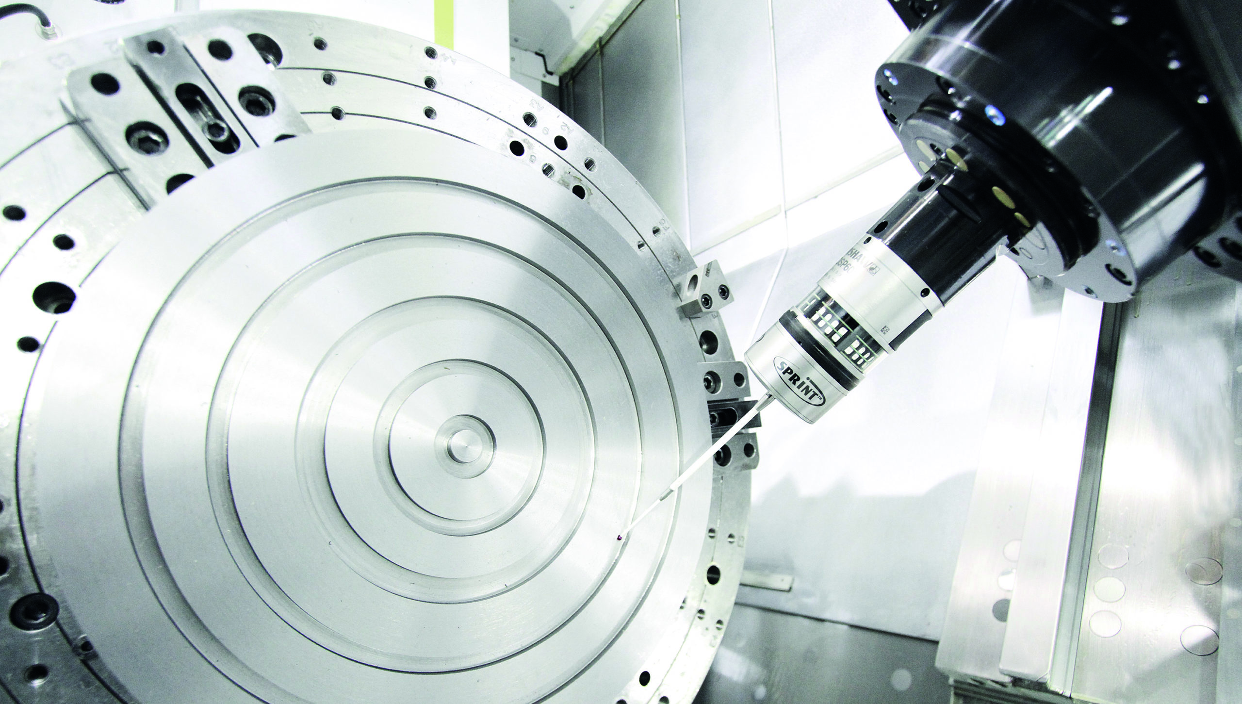

For the implementation of the concept, NILES-SIMMONS introduced several new machining and measuring technologies. In doing so, it is now possible to achieve extraordinarily high accuracies of <5µm in a process-reliable way by the use of scanned part measuring through a RENISHAW Sprint measuring sensor and automatic tool compensation after the measurement cut. As well as Sprint, there is also another various touch measuring sensors such as RMP60 or RMP600 fitted to carry out other measurement tasks.
At the same time, the measurement of all necessary tools also takes place, again fully automated within the machine using a touch probe measuring system for fixed tools and an optic measuring system (laser) for rotationally symmetric tools.
