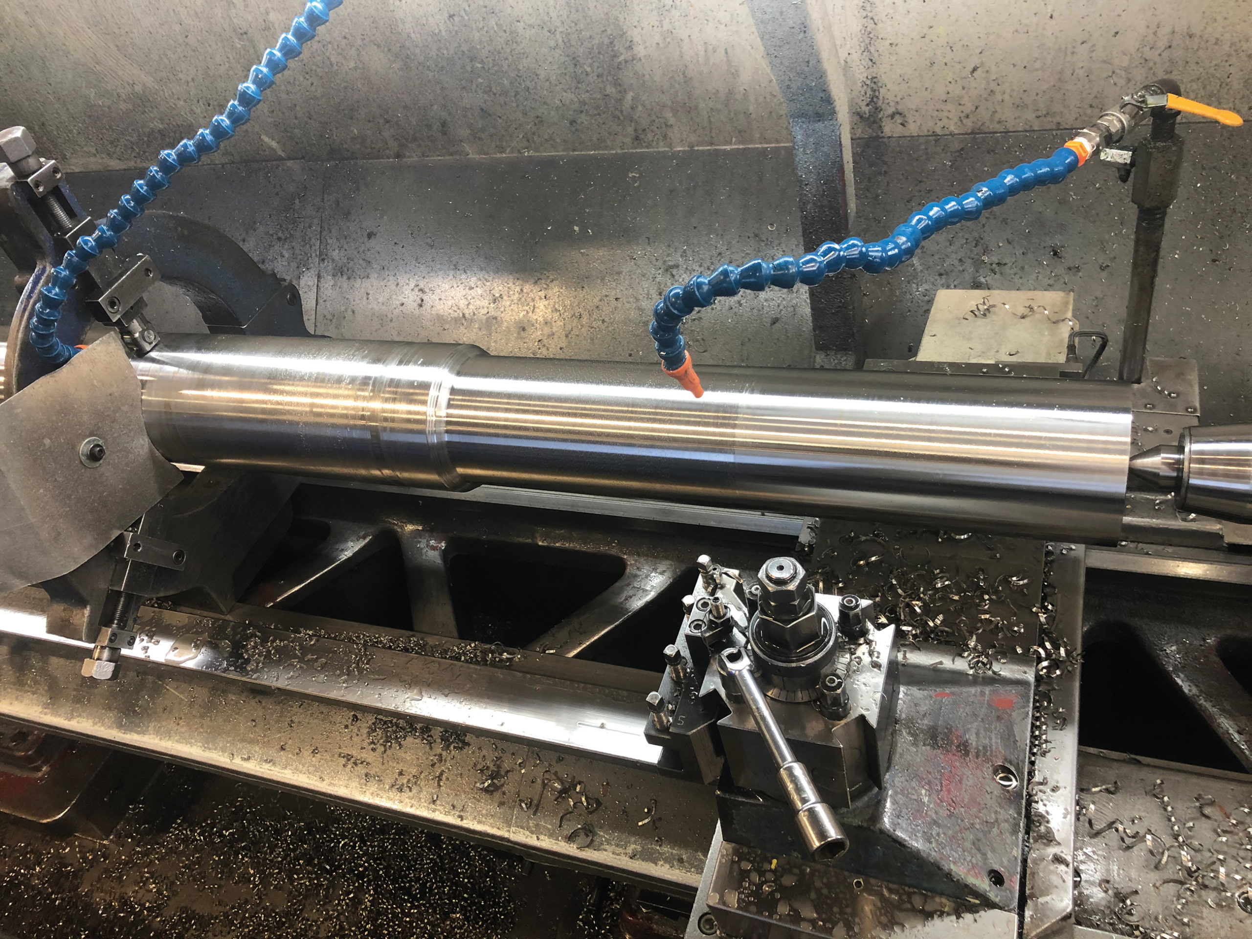

With an initial batch of five inconel 625 shafts to be machined from a 200mm diameter by 4m billet down to a range of stepped diameters from 100 to 180mm, the shafts require considerable material removal volumes. Rough machining the shafts to just leave +2mm for semi-finish turning, the best carbide turning results typically yielded a finish machining time of 14 hours and 1 minute. This was achieved by applying cutting depths from 1 to 3mm with cutting speeds (Vc) of 40 to 50m/min and machining speeds of 80 to 200rpm.
The Ceramic Step Change
As MSC’s Stuart confirms: “We selected NTK’s Bidemic range of inserts and in particular the JX1 grade with a round RNMG12 insert geometry. This was because the new patented Bidemic range offers better wear and notching resistance compared to whisker ceramic grades.”
“The NTK trials started at a cutting speed of 250m/min, but we found the optimal speed for this job at 370m/min, a massive increase from 40 to 50m/min with carbide. We also increased the spindle speed from 80 to 200rpm to over 740 to 1000rpm depending upon the diameter being turned. Cutting with an average depth of 1.5 to 2mm, we reduced the rough machining time on the five inconel 625 shafts from 14 hours to 2 hours and 4 minutes per shaft. This yielded a Material Removal Rate (MMR) of 222cm³/min up from the previous rate of 30cm³/min.”
