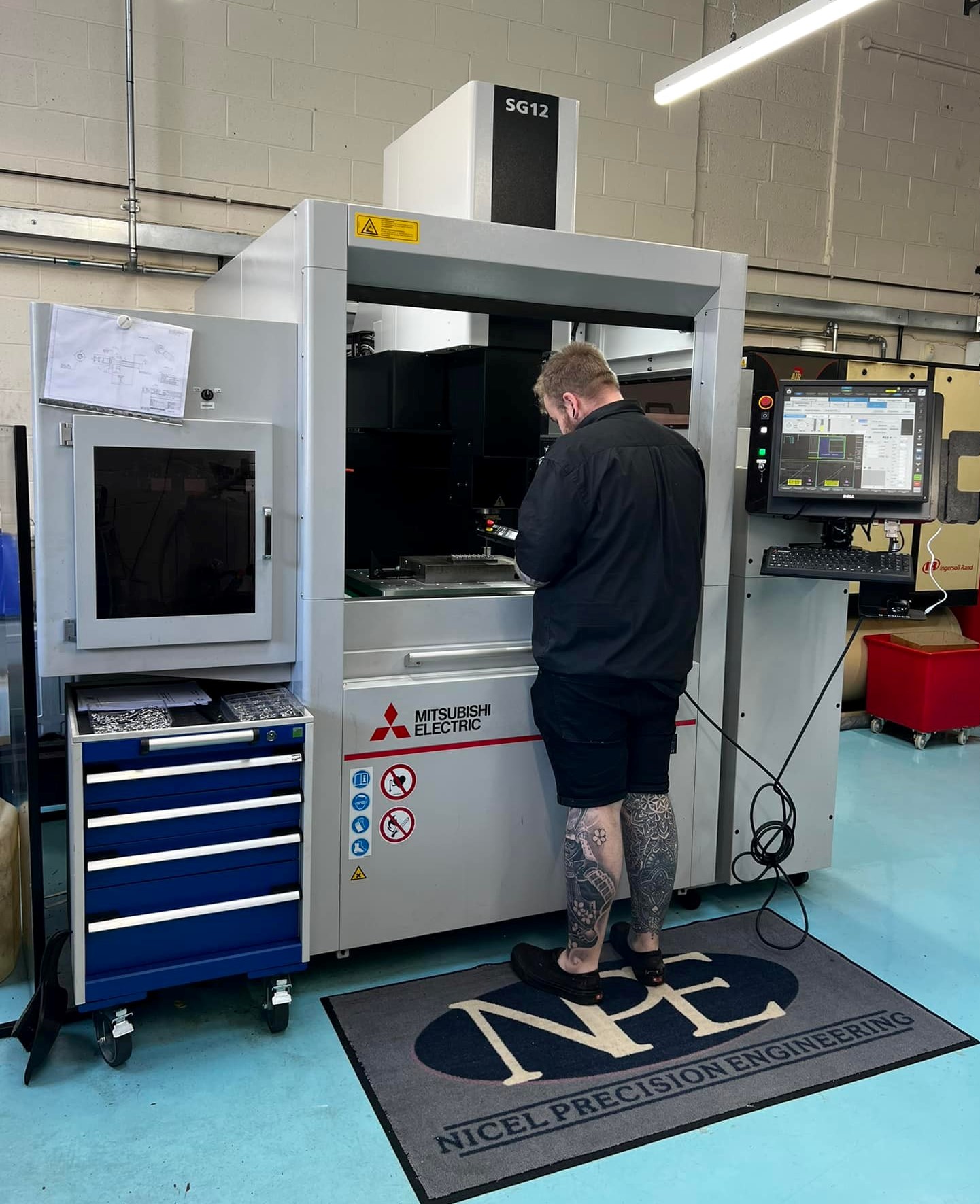

A new Mitsubishi SG12S EDM die sinking machine at motorsport subcontract machine shop, Nicel Precision Engineering is having a profound effect on productivity and throughput. The new EDM machine from the Engineering Technology Group (ETG) is reducing lead times and Nicel’s reliance upon external sources to an extent that the machine is largely responsible for increasing turnover by 20% since its installation at the end of 2021.

The company opted for the Mitsubishi SG12S from ETG, as Kevin adds: “The quality and the ETG service is a given, but we bought the machine for a few simple reasons. It has a self-probing facility that ensures every job coming off the machine is 100% right. We also bought it for its ease of use and simplicity. Another key point was the built-in fire suppression system which means we can run the machine unmanned overnight and additionally; the generator technology means the machine has a very low power consumption.”
Whilst Nicel runs a day shift with weekend overtime, the Mitsubishi SG12S runs complex jobs by day with simple jobs and batch projects to run through the night. As Kevin adds: “We have created our fixturing systems, so we can clamp 40 to 50 parts on the table and these will be processed overnight. With a 25-position tool carousel and automatic probing, it is perfect for lights-out running. We can set up a batch, run the machine overnight and they will be finished the next day. Previously, we would have subbed these parts out for £4 to £15 per part with a lead time of a few weeks. The EDM has eliminated the subcontracting costs and compressed our lead times to give us complete process control.”
