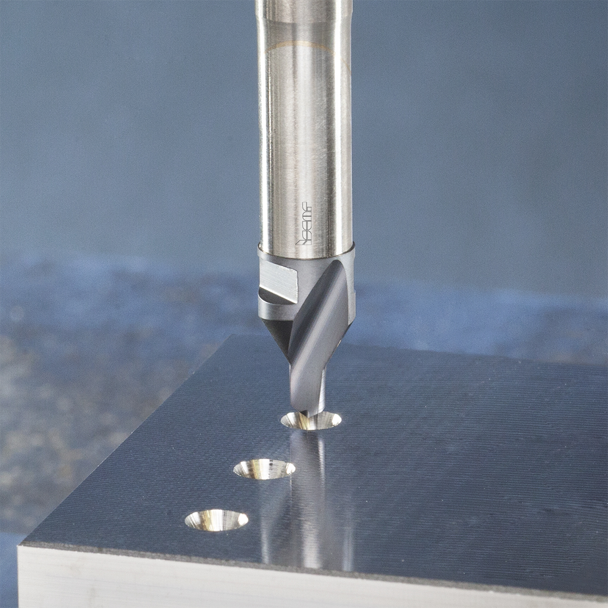

The MM HCD two-flute heads stand tall above other MULTI-MASTER hole-making products. These extremely versatile heads are made with various point angles – 60, 80, 90, 100 and 120 degrees which ensures a wide range of applications such as centre drilling, spot drilling, hole chamfering and countersinking. They enable conical holes for countersunk screws, bolts, and rivets according to ISO/DIN/ANSI standards in solid material. If the workpiece is pre-drilled, countersinking efficiency can be improved by using multi-flute MM EDF heads that increase productivity in chamfering operations. When chamfering or deburring the back side of a hole, the MULTI-MASTER double-sided chamfering heads are the solution.
Centre drilling is one of the most common holemaking operations. High speed steel double-sided centre drills have been the common tools used for decades to achieve a low-cost solution. ISCAR’s new MULTI-MASTER centre drilling heads have won undeniable popularity by providing increased tool life and productivity, even under strenuous cutting conditions.
NC spot drills are also commonly used tools. Characterised by their small cutting depth, these tools are primarily used on CNC machines for creating pre-holes that allow precise drilling without the use of guide bushings. For machining shallow holes, the MULTI-MASTER line has great advantages with NC spot drilling heads. A thin web at the head point prevents ‘drill walking’ or deviation during the machining operations. In addition, as a result of the 90-degree point angle, the heads can be applied to hole chamfering.
