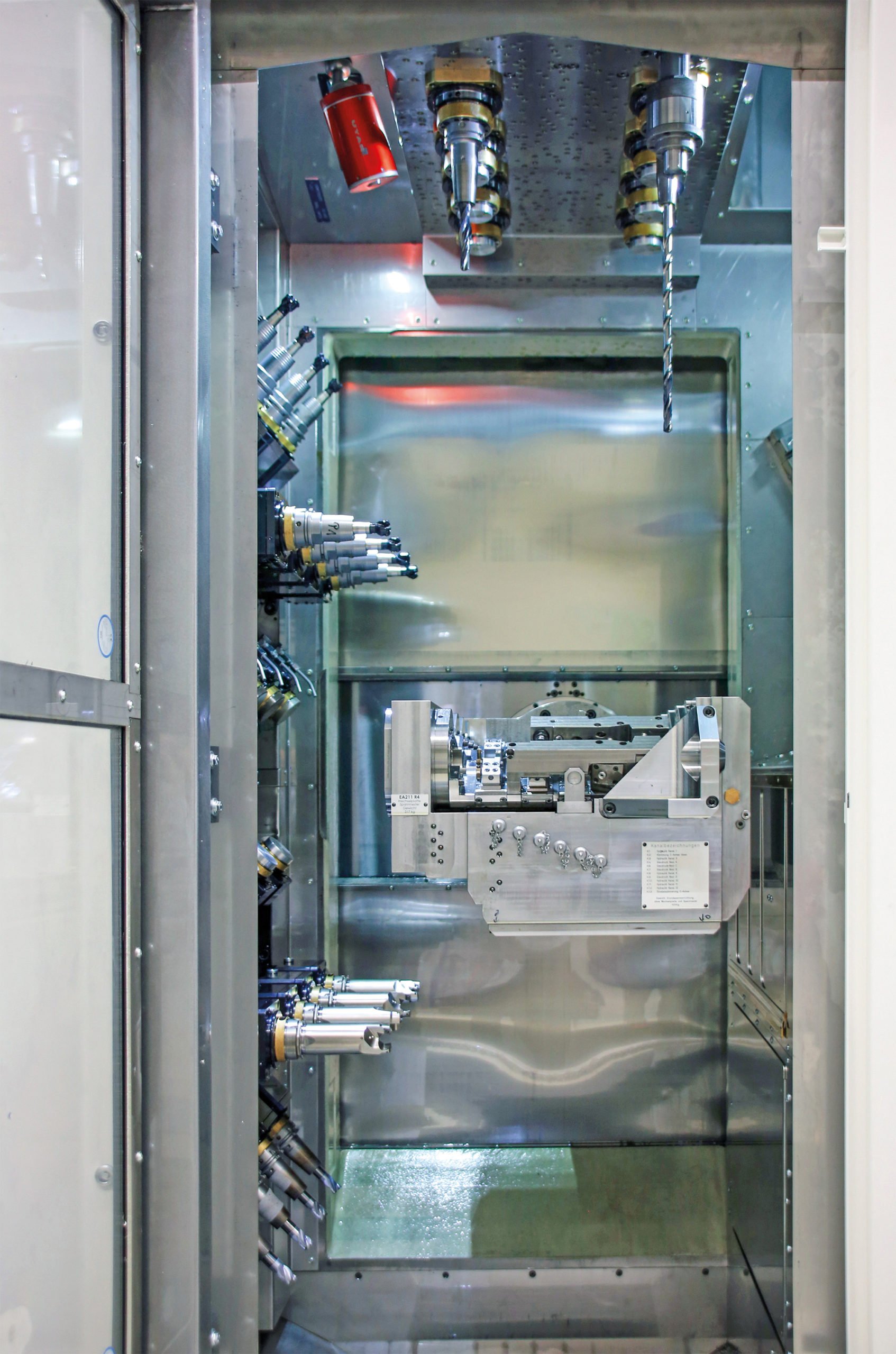

Another customer required a deep hole drill for machining stainless steel forged components. “This customer is a manufacturer of high-pressure fuel-supply distributors for petrol engines. This requires drilling deep bores in narrow, forged, stainless steel blanks,” says ELHA Project Leader Jörg Rodehutskors.
The difficult to machine job has a 300mm deep bore and the drill needs to experience as little axial deviation as possible, otherwise, the wall that experiences high pressure will fall below the required minimum thickness. Previously, the bores were machined in a separate, single-spindle machines with a single-flute deep hole drill. To optimise the processes, the customer asked ELHA for a solution with multiple spindles and parts leaving the machine finished.
MAPAL provided a drill with less deviation, less wear and faster cycle times. MAPAL developed a double-edged solid carbide drill designed to meet the requirements. With application parameters of Vc = 90m/min and f=0.5mm, the new tool life is 80m, three times longer than before.
